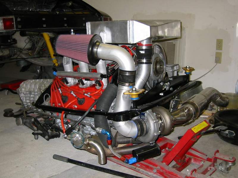

If you're getting rid of CIS it's no problem. I don't have any pics of my set up on this computer, but you could search for my previous posts. Due to the higher flow, I made a new larger intake pipe to the compressor. This may be more trouble than it's worth. Others, like DonE, have run a line straight out of the compressor around the inner fender and back into the engine compartment. I don't see why you could go straight off the compressor with a filter as long as it's sheilded from road debris.

It only takes a pebble the size of a pea to lunch a compressor blade. There are fewer pebbles as you increase the distance from the ground. Are exposed filters immune from road splash and mud too? No.

Here's a pic of mine. I built the inlet pipe from a 3" OD aluminum 90°. Even with the tightest elbow I could buy, it had to be cut and welded in a couple places to fit. I would have preferred to use 3-1/4" tubing but I couldn't get anything bigger in there.

OK, I get the message. I'll do as Jerry and David did above. Can't afford to take the risk
