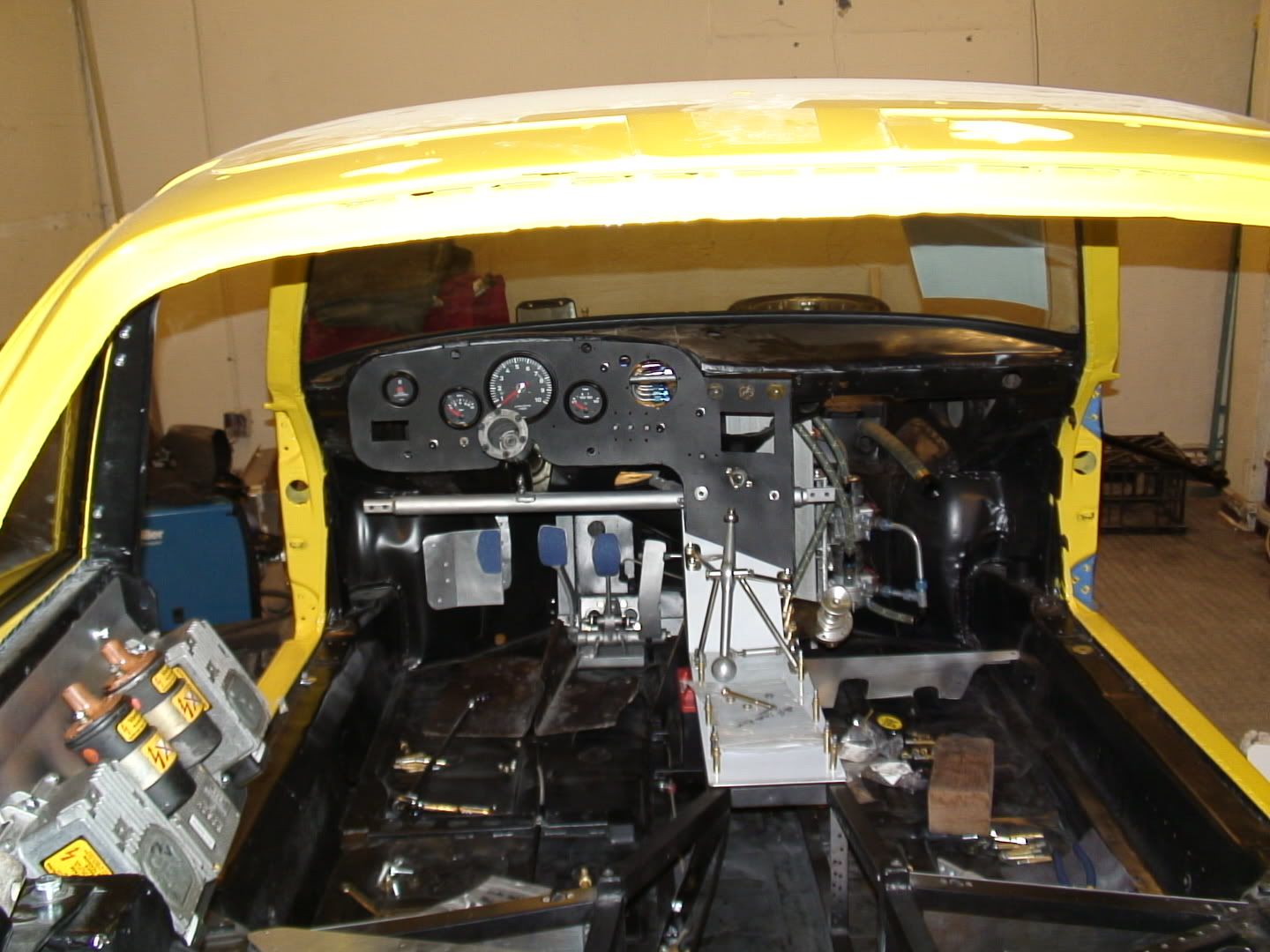

Please Post your "twin plug" engine bay
Just curious how all your twin plug engine bays look.
I am mounting my MSD boxes in the car, so where do you mount the coils? How do you route the wires? How do you route the wires to the bottom side? Through the tin?

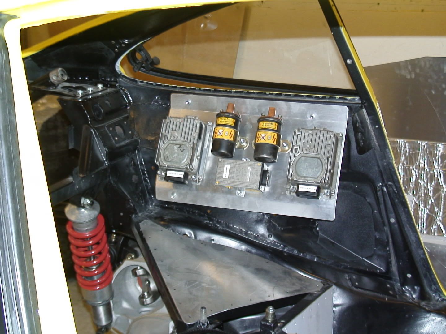

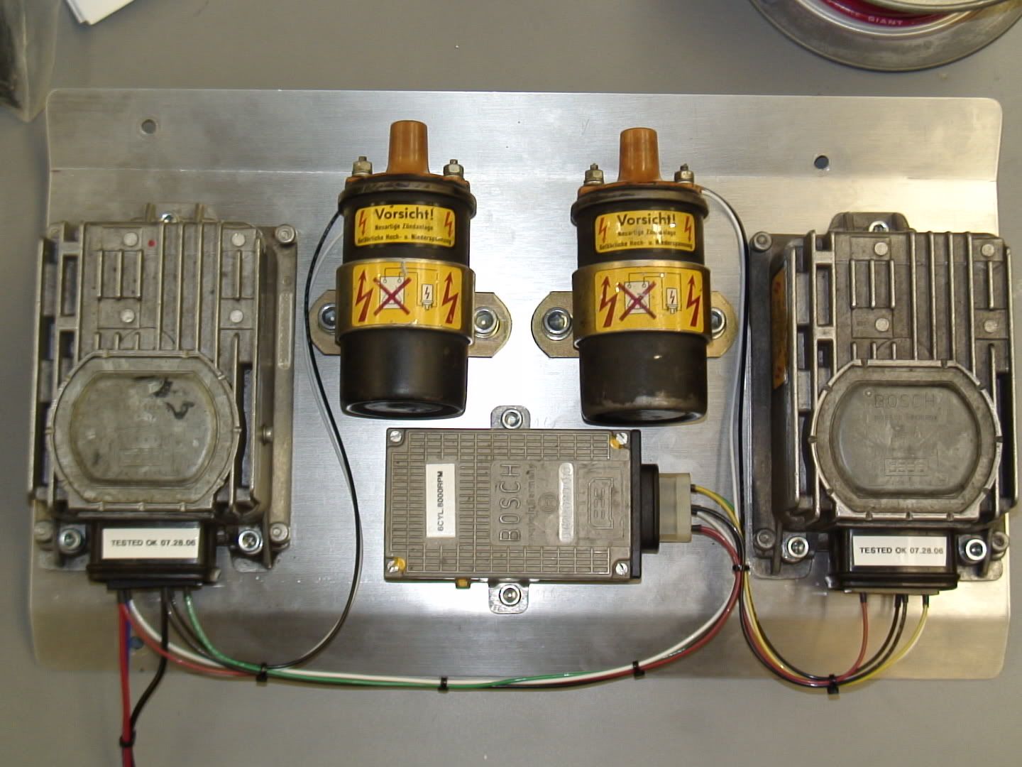

Here's a pic of my DFU's (coils) mounted and a pic of the aluminum bracket:
