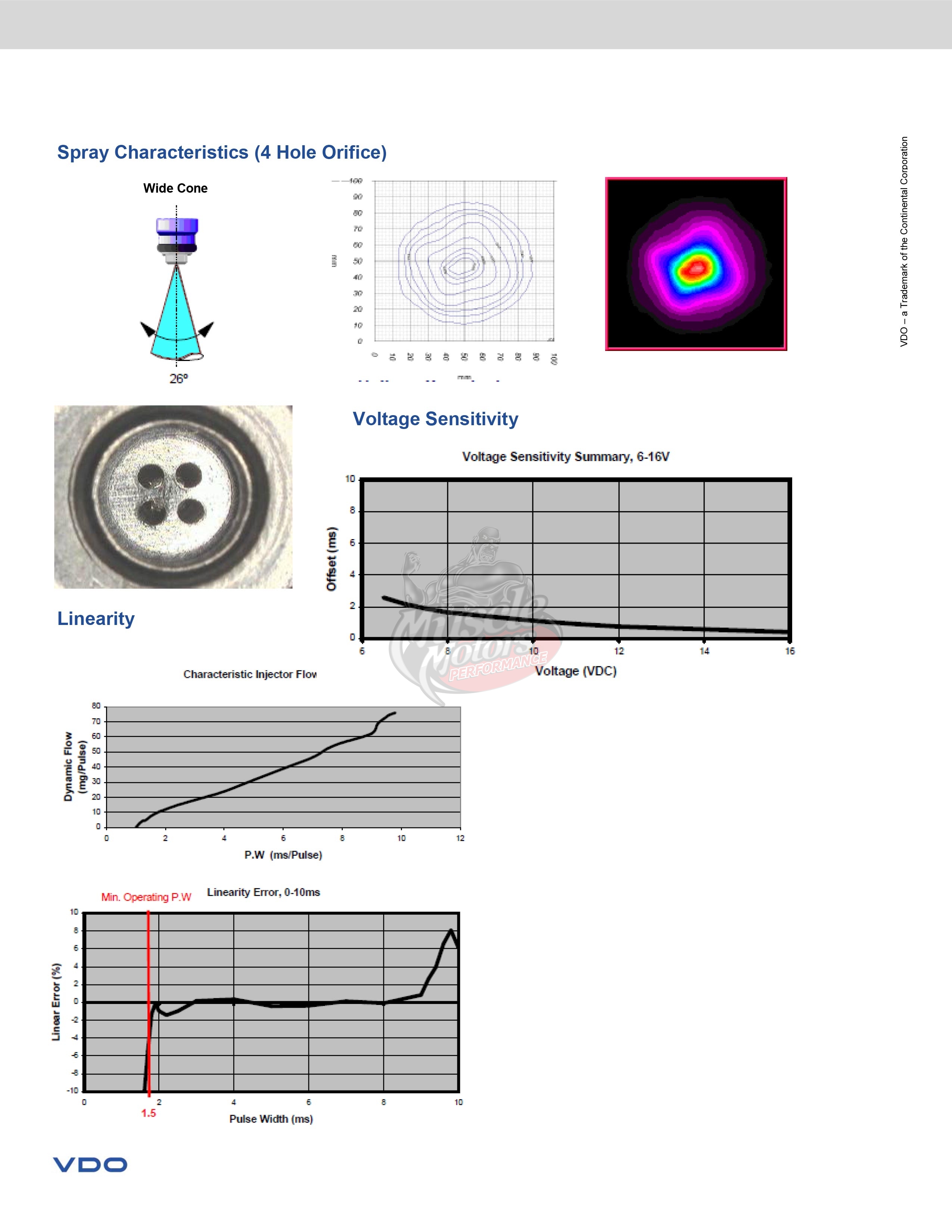

The 715 injectors are hi-impedance and have very different offset (dead) times. They will work but not correctly with the stock chip or any other aftermarket chip. I do have a solution that works properly with brand new Bosch OEM 759 (30 lb) injectors.
You certainly are free to try using the 715s but they will run lean at very low pulse widths because they need about 2X the offset (on time) than the original injectors. You may be able to hit the mixture setting at idle by adjusting the CO screw on the AFM but then you'll run rich at the higher loads.

You might also consider using Siemens injectors that are described as having:
"Excellent response characteristics
Robust Design
High Impedance
Low Impedance performance characteristics with High Impedance Compatibility "
60lb/h Siemens Deka High Impedance (Long Style) with EV1 Connector – FI114961 (60mm) | Muscle Motors | Siemens Deka Distributor
http://www.siemensdeka.com/wp-content/uploads/2012/08/FI114961-2.jpg

Originally Posted by scarceller View Post
3.2L Motronic Injectors are Low Impedance
If I have a choice, why would I choose a low-Z or high-Z injector?
"Until recently, most performance injectors with higher flow rates (900cc/min or more) would likely have been low impedance injectors. This is because in the older (fat body style) low impedance injectors (’80s and ’90s designs) had faster opening response times and generated less heat when they were being operated with proper peak and hold injector signals. This meant that at higher flow rates and lengthier duty cycles low impedance injectors would outperform their high impedance counterparts. Since so many of the performance injectors back then were low impedance injectors and they were actually better than their high-z equivalents, the common belief which still lingers today (though it is no longer correct) is that low-z injectors are the best for your high performance vehicle.
Today’s high impedance injectors, however, are able to outperform those older low impedance injectors at larger flow rates due to their newer designs, tighter manufacturing tolerances and much lighter moving parts(examples are our 900cc, 1100cc and 2150cc/min injectors). A valve and spring assembly from a current high-z injector may weigh less than 1/3rd of the assembly from an older injector.
Thanks to this newer technology the current high-z injectors are more linear throughout their pulse range; they are able to repeat shorter pulse widths consistently which means they can provide excellent part throttle and idle characteristics, and operate at higher maximum operating pressures.
These facts make choosing one of the new high-z injectors we offer a no-brainer if your ECU and fuel system setup allows you the choice, and the budget will stretch to the slightly higher average cost."

You can not just put a hi-imp injector in these 84-89 3.2L engines, the injector offset times are 2 to 3 times greater for the hi-imp injector than the lo-imp stock inj. You can use hi-imp injectors in the 3.2L but only with a custom chip that has the proper injector offset times. I know this because I have used Bosch 30lb hi-imp injectors in these motors with a special chip I created.
The DME has no issue firing hi-imp injectors but it must be properly programed for the given injector spec.

Just to re-cap. When the 3.2 DME was developed there were several challenges/restrictions in terms of what electronics was capable off and what injectors were available at the time.
Injectors needed to be low-impedance to achieve the required performance characteristics (short opening times, high dynamic range). So a high-performance injector was low-impedance for speed. The 3.2 fires all six of them at the same time and this compounded the problem: Each injector is around 2.6 Ohm but the net impedance is well below 1 Ohm with all six wired in parallel to the single injector output. That required really huge currents to work.
On the electronic side the technology en-vogue was a BJT transistor. Versions that could deliver enough current had low hFE gains. This resulted in poor conductance and big losses (heat) in the transistor. Because of that a Darlington configuration had to be used. Even then a peak&hold scheme was required with a sophisticated PWM driver. It shocks the injectors open for less than a millisecond and then uses current feedback to maintain a lower holding current via PWM. Additionally the energy coming back from the injectors had to be dealt with by more circuitry. This made the drive circuit very complex by modern standards and required propriety Bosch parts that are NLA.
Fast-forward to today: high-impedance injectors are much faster and perform comparable to their low-impedance counterparts. In addition modern low-side drivers with MOSFET technology can deliver extreme currents with very little losses just like a switch. This makes design much easier. Bosch went to sequential injection in the 964 where each injector has its own channel.
But as others said the old 3.2 DME can drive high-impedance injectors without problems. It's just important that the flow and characteristics are matched or differences are accounted for in the programming of the maps in the DME.
