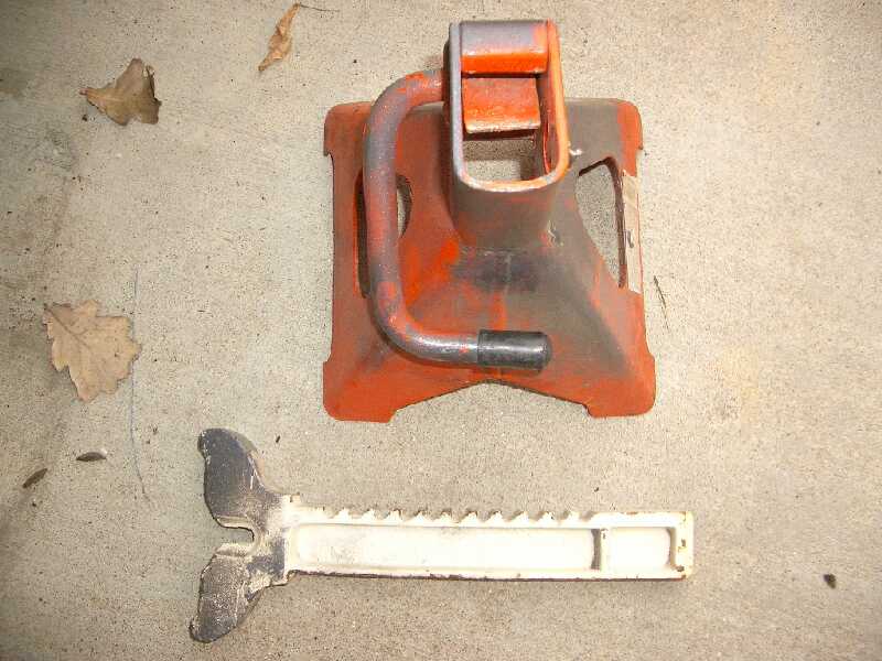

Scary. You have to go to pg 5 for the cause - he thinks he elbowed the release on a worn rachet-type jackstand.

OK, I like safety reminders, but I've not seen any stands that could get that worn out in a life time. And, with a load on them, you can't budge the lever. The victim of this had to have the ratchet all they way on the cog.

We had an incident with a jack stand at work last week. I was going to post pictures on here.
Essentially, the stand was overloaded while lowering the truck (all of the weight on one corner) and the back side of the stand peeled away and the truck fell. No body was hurt.

That isn't worn, it's trashed. Someone used it to hold up a tank at some point.

Preface:
A few years ago I was working on my MGB, and it came off its stands and fell on me. I can't tell you how lucky I was; the car had me pinned, but the overturned jackstands took the weight. Even then, I was home alone for 2 weeks... I could've starved under there if I hadn't been able to wiggle up a jack and use it to jack the car up an inch. Scary, scary stuff.
Ever since then, I've been ANAL about getting under cars. Once the car is on stands, I always go to each corner and SHOVE. If it moves, I start over.
Onto the current fiasco
A couple months ago, I was working on my neighbor's '72 westy. I had the front up and was about to get underneath to work on the shift linkages. I got the van onto stands with the wheels off, and then walked to the front and gave it a hard shove.
I heard a "PING", and then it wobbled a bit. I crouched over, and pushed the van as I looked. On one of the stands, two legs would wiggle; the other two stayed in place. I turned around to get the jack, and the whole works came tumbing down.
Here are the pictures I just took of the stands:
Now, look at how the horizontal bar is free from the legs of the stand:
A closer look at where the bar broke free. Look at that weld... do you think it had sufficient penetration?
The second stand, which folded under the van, shows a similar quality weld:
These stands were 2, maybe three months old when they failed. It really scares the $chit out of me... how many of us check the weld quality on our jack stands? I never did before, but I can promise you I sure as hell do now!
Be careful out there folks!
