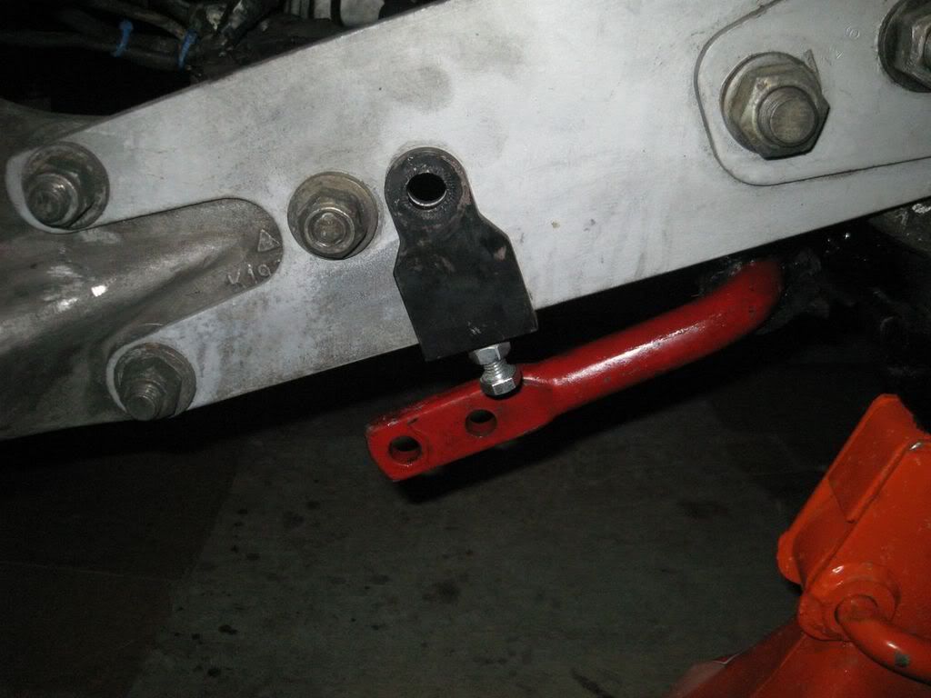

Today just finished wevo mount welding tomorrow I will install it with Tarret a. droplink Jeff is right not much meat just drill 1" c to c . I rec. do it in machine shop, BTW the droplink is mounted between sway bar and spring plate not trailing arm. I will post some picture tomorrow.

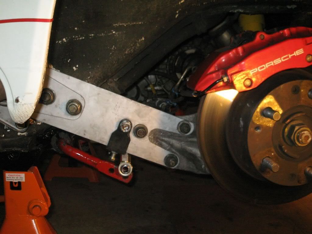

Here are the pictures

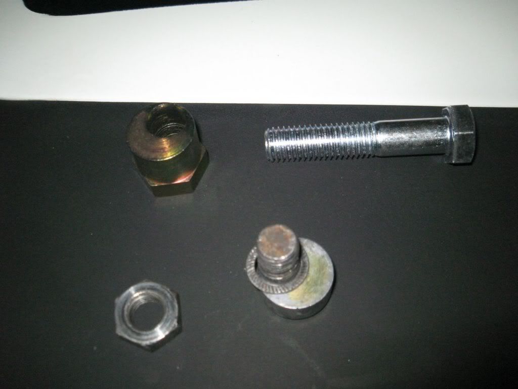

Ryan,one thing I am confused too the drop link comes with cam bolts which replaced factory
Eccentric bolt but the cambolt is free play between the bolts and cam not like the factory solid piece so I do not know the alignment guy know to adjust.
Remember send the sway bars to machine to drill,it is special steel, I also install ER cambermax.

Is it better to mount it to the spring plate instead of the trailing arm? I assume so but unsure why, other than maybe not adding other forces to screw up the alignment settings and for freedom of movement of the trailing arm.

Ryan I also feel a bit uncomfortable and agree with you, but the instruction from tarett is mounted in spring plate, I also edit the post under the picture, if someone have any comment pls advice me . Thanks

Posts: 225
that the different between factory bolts and tarrett cambolts.

Don't worry about mounting it through the springplate. All quality aftermarket bars (SRP TRG TARETT) mount there. When you are cornerwieghting or aligning the car just disconect your adjustable drop link. Then when you are done hook it back up and adjust for zero preload.

thanks Jeff but I still confuse with the eccentric cambolts come with the droplink how to adjust.
