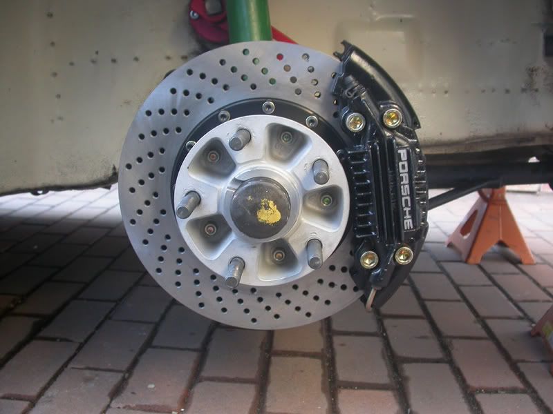

Does anybody think those rotors might be on the wrong side of the car?
They came in boxes labelled left and right, but it just doesn't look correct. Also I notice that the vanes curve the opposite direction of the rear rotors which were also labled left and right.
Matt West
1980 911 SC
Old 05-28-2007, 10:41 AM
Location: San Diego CA
Posts: 697
Matt,
I believe they are backwards... same thing happened to me. This is how mine look now - after correcting them.

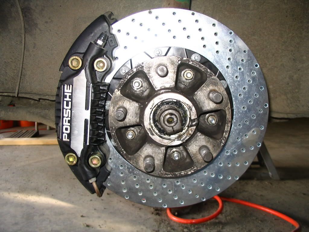

Just for perspective, this is a pic of the right side (pass).

check the vanes carefully- they should angle towards the rear of the car.
Brembo made new rotors where the cross drilling is OPPOSITE of the vane direction.
This will make no difference in braking- just a lot of comments!
