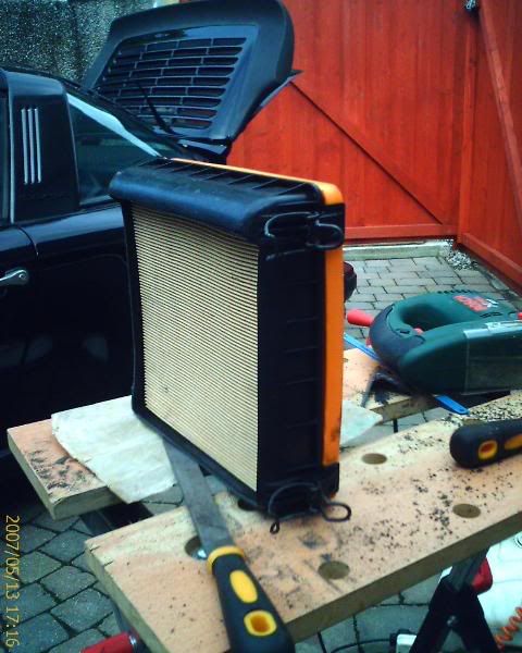

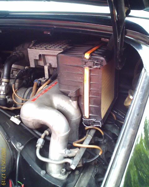

Posts: 51
I went down the route of "topless" airbox aswell. Picked up a spare off ebay and went to work with the jigsaw mimicking the fabspeed one. I left as much at the top as I could to act as a bit of a rain lip, I'm pretty happy with the way it turned out, and does free up a bit of space in the engine bay.
