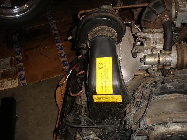

Well for the last day of the year, I decided to drop my motor and came across a few issues I'd like to take care of.
I have 3 questions for those that know the answer.
  1. Can I remove the heater unit (big black box with Shell sticker) altogether and not have any idling or problems down the road?

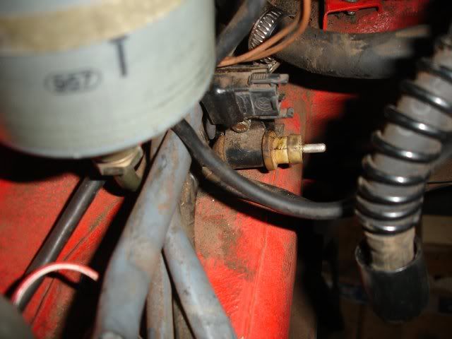

  2. How do you replace the exhaust sensor ceramic piece that's in the engine bay? Man this thing is brittle!
  3. I also removed the cruise control unit, will this cause a vacuum problem?
Please see pictures
I'm pretty sure I'll be okay with removing the Heater and Cruise Control, but I just want to be sure. Nothing like putting the engine back in and find out I shouldn't have done that!
The engine is a 3.2 DME and I'm changing out my clutch and flywheel, but now it's the...while I'm in there things to do situation.

you can remove the heater box (black thingy) it wont affect the idle.
The other two i am not sure

1. yes you can, but you will have no heat
2. that white connector with one single pin is the o2 sensor. That does not look bad.
3. Do need to plug up the vacuum hose going from engine to cruise control. Or, you will have idle problem.
Agreed, doesn't look bad at all. Mine is cracked BAD and I need to replace it but I can't seem to find that part on Pelican.

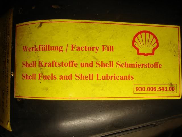

Your photos
Thrlls,
Nice photos and descriptive questions. You are on the right track.
I did notice that you had the "Shell" sticker on your rear fan plenum. Would you mind taking a close up shot of that sticker and send it to me?
I would appreciate it very much. I plan to reproduce them for some club members here in Houston doing restorations.
Robert
That is the mating connector for the O2 sensor plug - it is not the actual O2 sensor. I believe that connector is part of the engine harness assembly and is not available separately. Others have salvaged that connector off harnesses from parted out cars. And yes, it is brittle. The one on my SC is broken in half (but still functional).

Originally Posted by Robert Buchanan View Post
Thrlls,
Robert
911_pilot
No problem!
PM me your email addy and I'll send one off, or I could just post it here if you like.
Thank you for the info. I figured the o2 sensor was on the exhaust, but yep the connector is what is cracked in half. I'm going to try and Super Glue it together and hope for the best. It's comforting to know yours still works...hopefully mine will too!

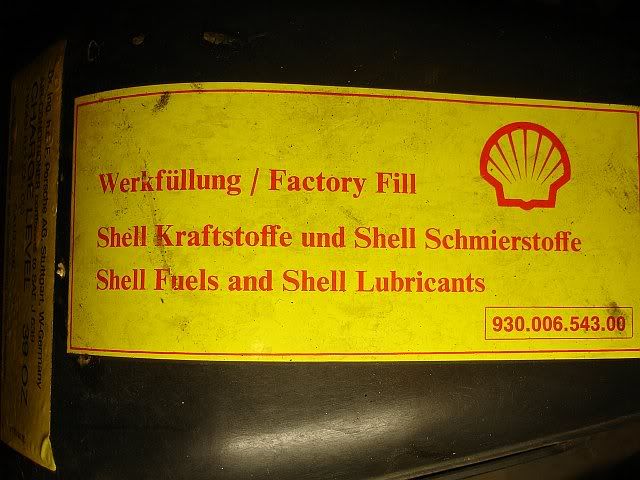

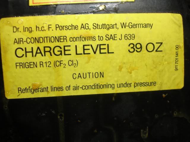

Pics of the Shell Sticker and AC Sticker:

Porsche Crest Shell Stickers
Thrlls,
Thanks a million for your time.
I appreciate the excellent photos.
Robert
