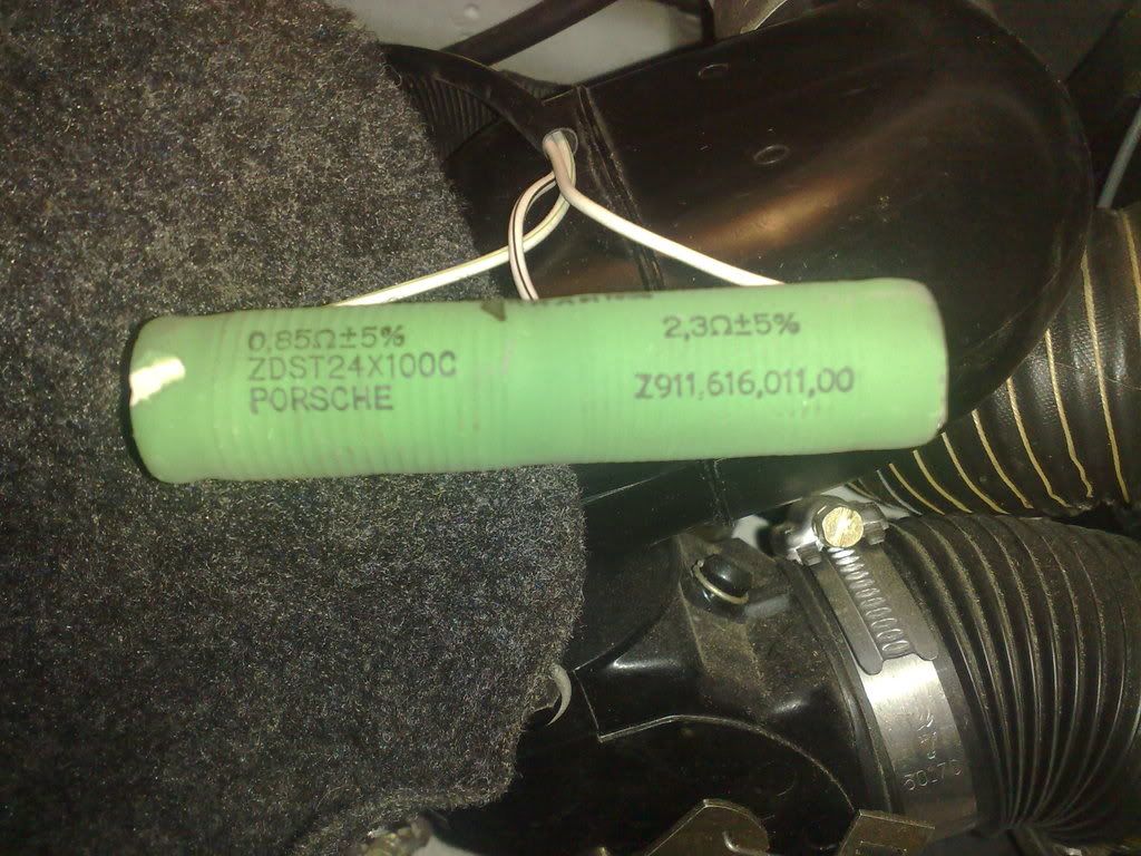

And where are those resistors?

issue #1: i tried to measure the resistors, but it seems i measured the ones for freshair blower, in the fire wall, in the luggagecompartment. ( i will test these tomorrow)
issue #2: yes they should be running at full speed, but they aren´t

Some cars did have the resistor pack in the front luggage compartment on the passenger side below the windshield. So you may have found them. Not sure what resistance they should be but they are most likely very low resistance (below 100ohms). Just be sure they are not burned out (open circuit).
Then the way the controller works is that when pin #9 goes to ground it activates the large internal relay, this relay turns on the rear blower and thus activates the reed switch. Then once the reed switch picks it activates the smaller internal relay that powers the front footwell blowers. So the idea is to ground pin #9 and see if the rear blower gets power on pins 5&6. Then once the rear blower is running then the smaller relay activates and you should see power on pin #4 to the front blowers.
So simply grounding pin #9 should first produce power on pins 5&6 then if the rear blower is connected it should come on which in turn picks the smaller relay and produces power on pin #4.
For testing the controller I suggest just keeping the Rotary switch on Pos #10.

Old 02-18-2009, 10:57 AM
Jaskas's Avatar
Join Date: Jul 2008
Location: Finland
Posts: 401
Hope this helps.
This was the resistor in the luggage compartment:
It was easy to measure...
I have jumped the reed swich to eliminate it also. So the smaller relay should be activated always when the temperatur swich is in pos. 1-10 ?
And the from the swich you can choose, trough which resistor (s) does the current go trough... am i right?
more testing tomorrow...

Old 02-18-2009, 11:18 AM
scarceller's Avatar
Join Date: Oct 2006
Location: Southern MA
Posts: 4,004
Yes,
That's the correct resistor. Looks like across the entire resistor is 2.3 ohms and this is for lo-speed. Then across another section it reads 0.85 ohms and this is for med-speed. Hi-Speed is NOT routed through this resistor at all.
Also, I did some more research on auto-heat and the rotary switch 0-10 positions sets the desired cabin temperature and compares it against the actual cabin temp which is measured by a sensor located to the left of the heat levers in the center of the dash.
This means that if the cabin is already warm enough then some positions (like 1-7) might not turn on the heat. Bottom line is your system may be working just fine. I think it needs to be real cold for pos 1-7 to turn the heat on.
So for now simply set to pos #10 and see if heat comes on.

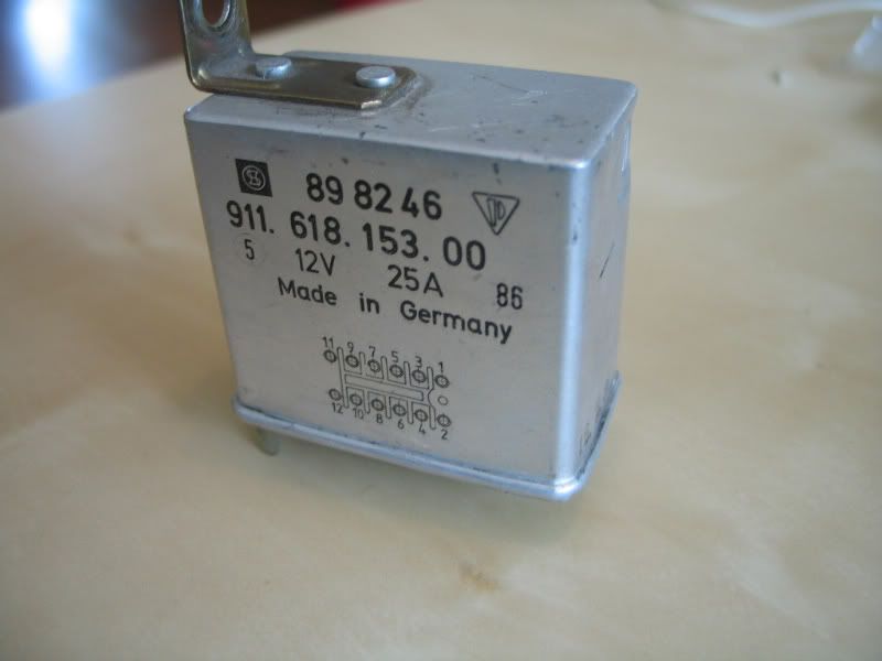

Jaskas's Avatar
Join Date: Jul 2008
Location: Finland
Posts: 401
I tested the pin 9 grounding issue once again. It is in ground when switch in positions 1-10, and no current to pin 4. -> FW-blowers wont work.
The engine blower works as it should, and it gets offcourse 12 volts...
When push the footwellblower relay in the controller manually down ( with a skrewdriver ) the FW-blowers work as they should.
So it think that the footwellblower relay in the controller is broken.
Can i replace it with something like this :
911-87 mit der 3.6 V-Ram und alles spaß
Old 02-19-2009, 08:25 AM
scarceller's Avatar
Join Date: Oct 2006
Posts: 4,004
I agree, you have a bad controller.
You can replace the ENTIRE controller with 2 relays like the one you suggest, see post #35 for howto wire them up. I did this modification in my car to simplify the parts in the engine bay and use 2 simple relays. I cut off the old harness and then wired the new relays. Be careful and DO NOT mix up the 2 yellow wires (pin 9 and 11).
Since you already have a bad controller you could gut it and simply wire the 2 relays into the old controller and not alter the harness, I suggest this approach.
Also, if you only want to run the front blowers and not the rear you will only need one relay, see the schematic in post #35
I also have a working controller I would sell if you want it, PM me.

Old 02-19-2009, 08:37 AM
Jaskas's Avatar
Join Date: Jul 2008
Location: Finland
Posts: 401
Thanks again Scarceller!
I did your double-relay modification, and now everything works as it should.
