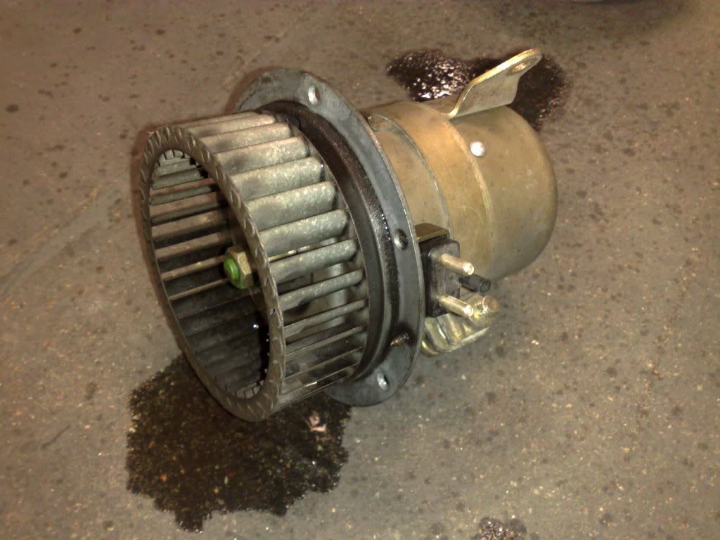

Does anyone have a pic of the actual rear heater blower unit?
This one is already SOLD but here is a picture of the blower and the inlet duct, the blower is in the rear engine bay left side:

Thanks...where does it mount?
I have a 3.6 in my SC, and planning on mounting footwell blowers. I'm using custom 993 HEs that need a cross over for both sides to work....., but I can't fit it in due to space under the longhood, body work on the back....cat and muffler are in the way.
Suggestion, if you are going to put in the front footwell blowers then DON'T bother installing the rear blower. I'd simply backdate the rear tin to the 74 style heater duct on the left side only and plumb that duct to the cross-over tube. So the cross-over tube gets it's input air from the left side behind the distributor, then the front blowers will pull air into the cabin. This idea will reduce pounds and clutter in the engine bay.
Or - you could simply let the cross-over tube draw air from the engine bay area and simply let the front blowers pull air into the cabin. Only danger with this is to be sure the cross-over tube is not drawing in exhaust. Bottom line is that the front blowers are more than enough to draw plenty of heat into the cabin you don't need any rear blower. My 84 car has no rear blower, engine tin backdated to 74 style and SSI heat exchangers then I simply run footwell blowers I have tons of heat even in 5deg F weather I have to turn the heat down.
see pic no.3 above
