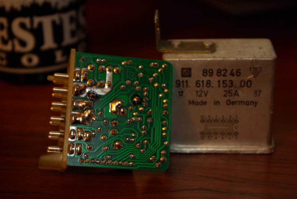

Talewinds,
Glad you found a solution! But I still don't fully understand what you did? Partly because I'm not sure how the reed switch in your controller is setup.
In my older controller it works like this:
The large relay for the rear blower is picked/activated the minute you lift the levers (pin 9 and 11 shorted together by the switch on the levers) Once this large relay closes it puts 12V on pin 5&6 but as current flows to the rear blower (via pin 5&6) it passes through the coils in the reed switch (the coils wrapped around the glass tube). Once enough current passes through the coils it causes the switch inside the glass tube to close and this in turn picks the second smaller relay for the front blowers. Once the smaller relay closes it sends power to pin #4 which powers the front blowers via the rotary switch between the seats.
Here is the pin out details:
pins 8&7 have constant 12v and are the input feed to the large relay (rear blower)
pin 3 has constant 12v and is the input feed to the small relay (front blowers)
pins 5&6 are output from the large relay that powers the rear blower
pin 4 is the output from the small relay that powers front blowers
pin 2 is ground
pins 9 & 11 are the signal lines to activate the controller goes to orange levers
then we have 2 special pins:
- pin 10 goes to a temp sensor on the engine and if the engine gets very hot it will cause the controller to command the rear blower on regardless of position of heat levers, the idea here was to move large amounts of air through the heat exchangers to cool them thus cooling the bottom of the engine, trust me this idea really works! Even if the levers are down the heat simply dumped out the heat valves at the top of the transmission, many folks in hot climates set the switch on the heat levers so it closes if you slightly lift up on the levers this causes the rear blower to run and thus keeps the exchangers cool all the time.
- pin 1 this is the mystery pin, it is the speed signal from the speedometer the same signal that feeds the cruise controller. I have no idea why the controller needs to know about vehicle speed but my guess is that it has to do with pin
#10 and maybe they turn off (or on) the rear blower at some certain vehicle speed. I never could exactly figure this pin out because it goes into solid state chips that have no part numbers.
Here's the rough schematic for the controller:
Then here is my circuit for replacing controller with relays, it is useful because it has all the input pins described:
I would like to really understand your controller and how that reed switch is wired and also exactly what you jumpered.
Thanks.
Sal

Talewinds,
After re-reading what you wrote a few times I think I got it: so in your controller pins 5&6 are the output pins from the large relay that feed the rear blower and you are saying that this same signal from pins 5&6 is feed to the coil of the small relay? if this is the case then the small relay (front blowers) will always put out 12v on pin #4 the minute the large relay picks. If so then my question is what does the reed switch output from the glass tube power?
Sal

OK, I see the difference here's a picture:

Just completed this. I had the same result. This is definitely the way to jumper for Carrera's with the modified/updated controller.
I replaced the rear heater motor(Wavey mod) and did the controller mod and now have the best of both worlds. I went from no heat to a Sauna in an afternoon.
BTW got the motor at Oreilly (Siemens PM351) works like a champ and has a warranty.

You have a few choices:
1 - The simple fix is to just jumper the reed switch as in the pictures above.
2 - Replace the entire heat controller with 1 simple relay. (I did this in my car) see post few posts up, I posted the wiring. I like this setup because it uses simple cheap SPDT 30 or 40 amp relay. Someone else in this thread also did this mod by gutting a bad Controller and wiring a simple relay to it, this way he could keep the current stock wire harness. I cut my harness and soldered in the new relay plugs directly to the stock wires.
If you remove the rear blower you can NOT force as much cool air through the heat exchangers. You give this up by removing the rear blower. But you still always have some air flow through the exchangers from the engine fan with the backdated heat configuration in the engine bay. If I lived in a very hot climate I would not remove the rear blower.
BTW - I have my old controller listed FS on this sit, it's already modified and ready to go. I don't need it any more and never will.

I can't tell what's working and what isn't at this point. The footwells are emitting significant heat but they don't come on with the ignition energized and I can't tell what's happening once the engine is started. when I pull the on/off levers I'm pretty sure it's the engine fan generating the warm air flow at this point. My zero to 3 switch has no effect at all (which was the case when I did the PPI on the car a couple of years ago). I suspect this switch is faulty but will now start the process of diagnosing as you've detailed in earlier posts.
I normally enjoy the process of fixing things but my patience is wearing a bit thin on this project.

This is my first post. I just replace my 79 911 SC that I lost in Hurricane Katrina with an 88 Carrera. Its good to be back in a Porsche.
This was a good read. More information then a double E can handle. Maybe one you guys can help me figure this one out. My rear fan blower motor get 12 v, (11.97v) but will not run, however when i hook the fan direct to the bat. the fan runs great. With the engine running, pull up on the two levers in the pass. compartment, nothing either.
If the foot well fans are not working will this also make the rear fan not work.

Other way around: if the rear fan does not work (draw current) then the fronts won't work.
Look carefully at the schematic in this thread. If as you say you have 12vdc across the 2 pins in the harness to the rear fan the fan should run. If it does not I suspect a bad ground somewhere.

Yes I do get 12 v (11.85 v now) I'm thinking that the relay is faulty and not sending enough voltage to run the motor. If I had a bad ground, the plug at the fan would not see 12v.
440 volts I get, this 12 volt stuff is ??????
