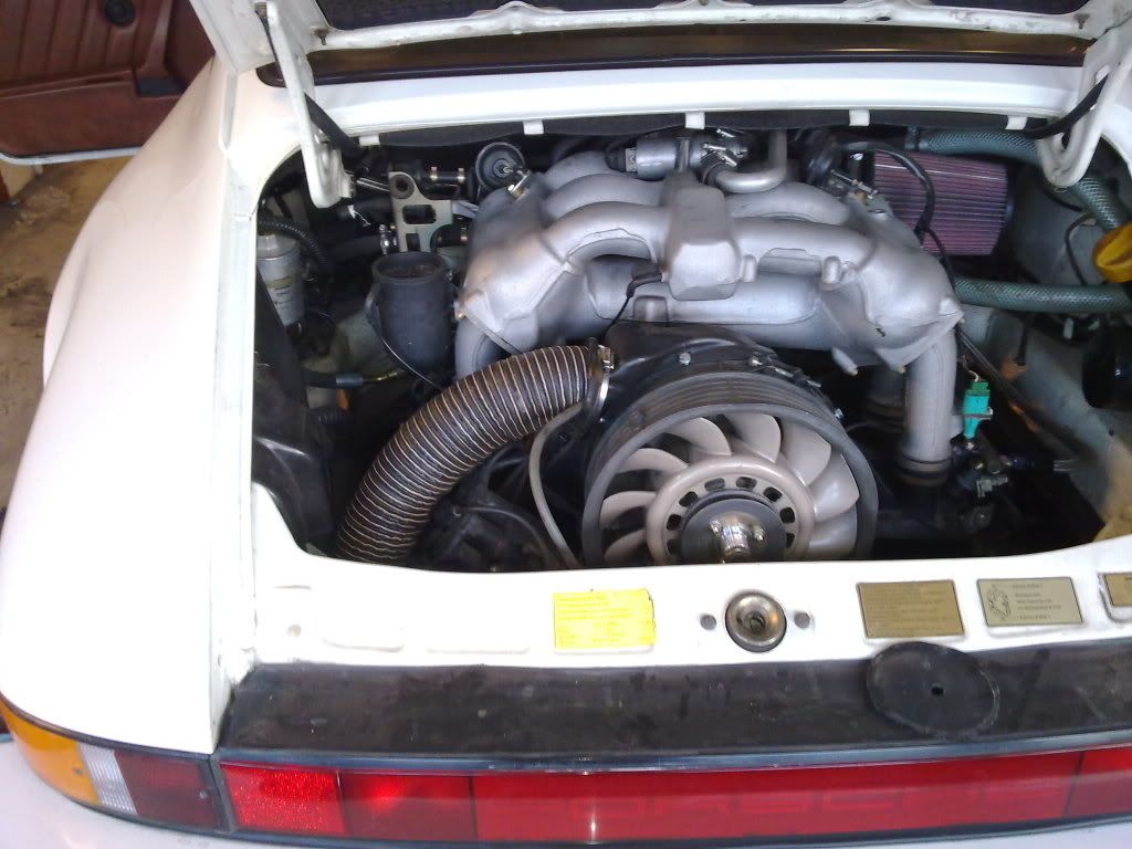

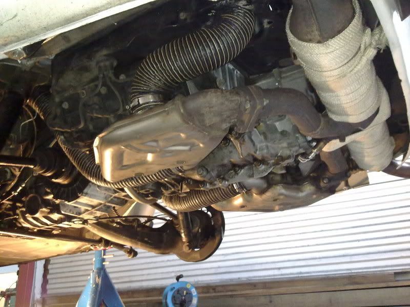

I dont think that the heater blower does that much cooling to the engine after shutdown. Its not connected in any way to the oil cooler fan either.
I did infact remove all the plumbing from the engine to the heat exchangers, but left the hoses from the heat exchanger to the car + the footwell blowers. This generates plenty heat, even this morning there was -5 celcius and the car warmed up fast. ( You have to have the footwell blowers sucking warm air to the cabin)
Here is the hoses that i removed:
I the pic below you can see also the hoses from heatexchanger to car.
