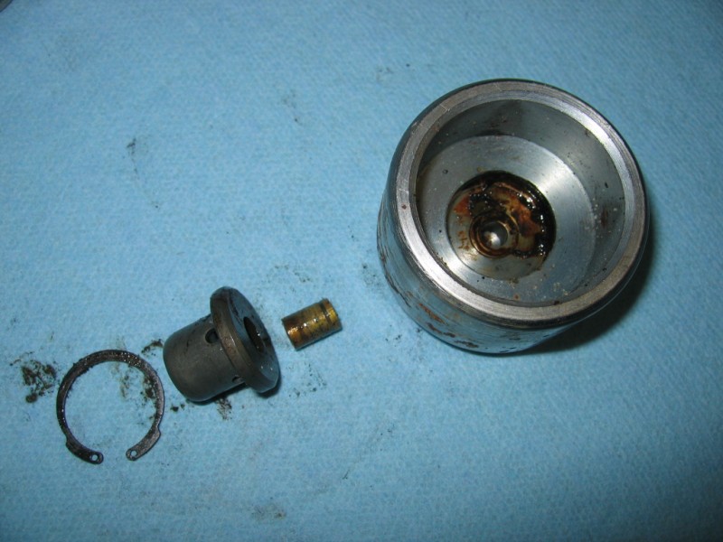

These are not "guide" pins. They are knock-back pins. ATE literally did away with them in the mid-70's. Most calipers included this mechanism. Somehere around 1974 the M-Calipers began to come with the "cup" pistons we see in A-Calipers. Check rear M-Calipers from 74 on and you'll see what I mean. The cup pistons afforded better cooling by having more surface area.
Armando, the pins were never installed in the Mag calipers you have or the very early (if not the first) 908 caliper that Dave has. I've heard from an old pit boss that they used to practice simply breaking them off as they could bind in a racing situation costing the team the race.
Back to the original posters question dilemma; The pins have always been 5mm. I've measured all of them from 69 through 76. My guess is you have other things hanging up your piston. It is very common to have the piston off kilter only slightly and have it hold up, especially in an aluminum caliper. I would use some caliper grease liberally around the bore and lightly on the pin.
One other thing that may have happened is a bent pin. If you did not protect the opposite bore when removing your pistons, you may have bent the pin with the high pressure release of the opposite piston.

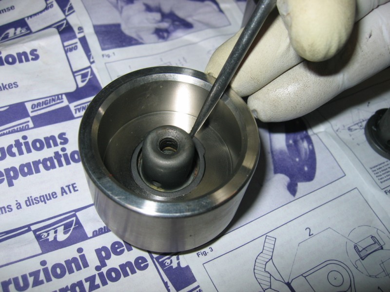

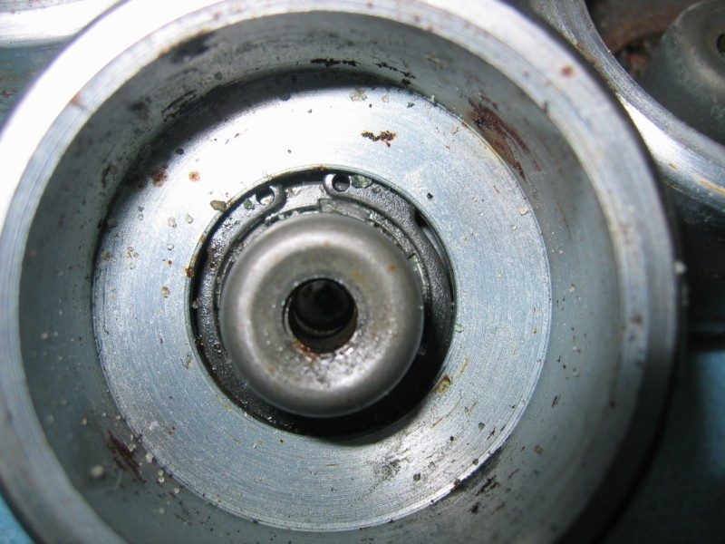

All S-Caliper (and M-Caliper) Owners. You have two options:
1. Leave the knock back mechanism in place when performing a rebuild.
2. Remove it. Rather than breaking off the pins (which we've done upon request in the past) I recommend leaving it in place and simply removing the mechanism from the piston. New SS pistons come without the mechanisms and you have to transfer them from your old pistons.
If you remove the mechanism and place it in a plastic bag in the garage, you have the option of using it again if you so desire. The mechanism is very easy to remove by simply inserting a small flat head screwdriver behind the head of the c-clip.
Removed:
Installing in a new SS piston:
Finished caliper:
