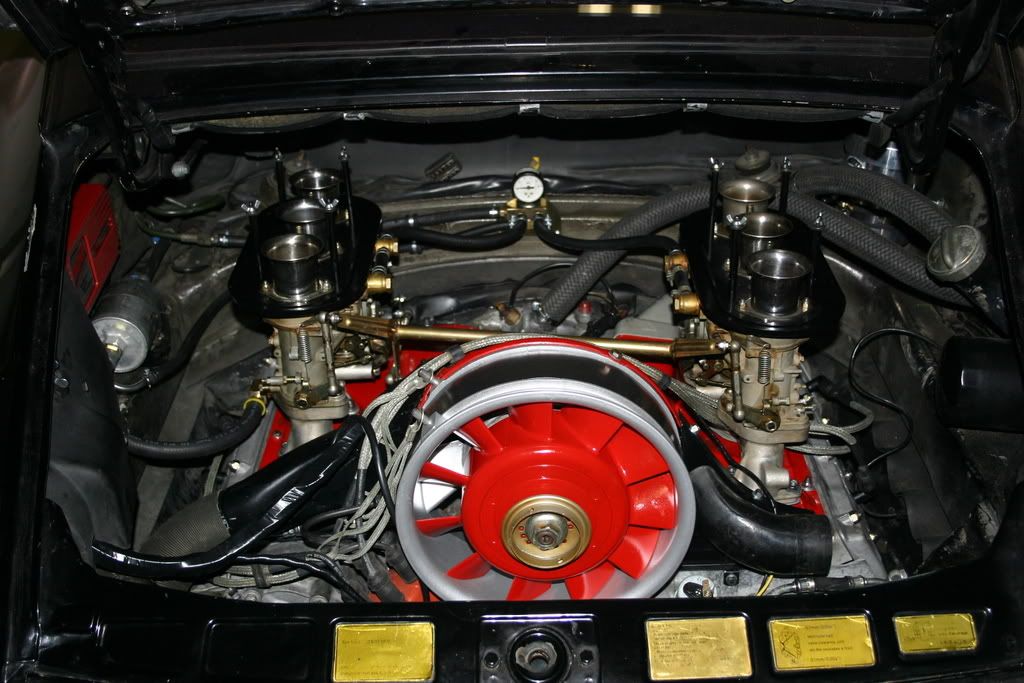

Heres my Car. It the process of 40mm webers, SSI, M&K dual in dual out and the MSD upgrade.
Cheers
Dizzy
