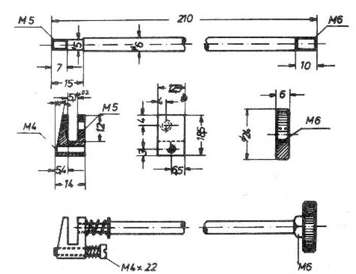

In the meantime, I've been reading the CMA bible again.
If I understand correctly, for part load, I need to set a 9 degree angle on the
throttle plates (butterflies).
Am I understanding correctly, that I can use either
A. the special tool that clamps onto the mfi pump, (pics below from cma)
or
B. the hand throttle
But, how do I measure the 9 degrees ?
I presume I can make a tool of some sort with the 9 degree angle, but I just cant see how I can measure 9 degrees without the protractor.
Please tell me I'm just being silly, and its simple.
Thanks,
Declan
