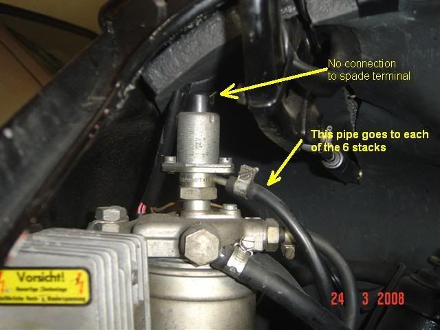

Hi folks,
Had a quick look and found the following :
MFI Pump is Bosch # 0408 126 019 which is correct for 2.7 according to CMA manual. (Porsche No. 911 110 254 00)
It also has numbers 472R and 928 stamped onto the PUMP body near the Bosch ID plate.
Only other numbers I can see are on the end of the thermostat housing.
1 425 500 007
1195 226

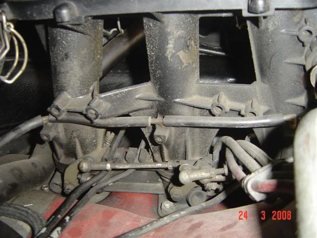

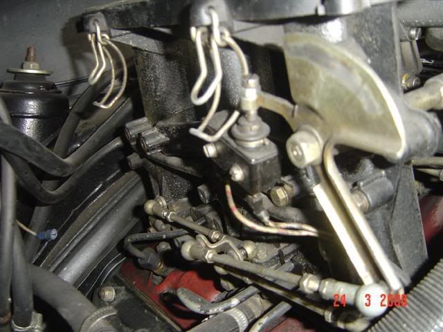

(I noticed the CMA refers to the 2.7 as the 911SC, mabye this is where the confusion about my "SC cams" comes from ?)
On the fuel filter, there is a solenoid on the top, with fuel lines going to each of the 6 intake stacks, but there is no electrical connection to the male spade terminal on the top. (see pic below). I did find a matching cable with female spade connector which looks like its the right length to fit on there. Can't remember disconnecting that at any stage though)
Solenoid number is BOSCH 0 330 106 004
I'm thinking this might be the "cold start enrichment" solenoid, so I guess I should just leave it disconnected & insulate the loose wire.
I have never had a problem starting.

Edit: Pics
Right stack, showing fuel feeds from solenoid
Left stacj showing fuel feeds from solenoids

Old 03-24-2008, 09:33 AM
Location: Higgs Field
Posts: 22,702
You are right, declan, that is the cold start enrichment solenoid. The disconnected lead goes to the thermal-time switch located on the breather cover. The other connection on that thermal-time switch goes down to the starter solenoid. When you turn the key to start the car and the starter is actually cranking, that wire feeds power to the thermal-time switch, which in turn feeds power to the cold start enrichment solenoid. Until the thermal-time switch heats up, then it opens the connection and quits feeding power to the solenoid. When that solenoid is tripped, it sends fuel directly to the stacks to prime them for starting.
The fact that the car starts easily when cold, without this system connected, further indicates the very rich idle and low speed condition you have already diagnosed. There has to be a lot of fuel coming from somewhere to start a cold engine, and if this circut is disconnected, it can only come from one other source.
Sounds like you have a copy of CMA. Also sounds like the motor has the correct 2.7 pump. That's only a part of the system, however. Unfortunately, there is no way to tell what the rest of it is without doing as Grady suggests. You could run all the way through CMA and see where that gets you, if you feel encouraged by finding it has the right pump. Might be worth a shot.

Jeff is correct. If the engine will start cold without the cold start solenoid valve functioning, the system is way too rich. After we do ALL the other stuff, we will get there. Remember the oil change.
BTW, there is a cold start enrichment solenoid on earlier MFI pumps (’69). It is a second solenoid just below the shut-off solenoid. It operates directly on the rack in the pump and forces it full rich – richer than the engine ever runs under other conditions. It is useful to use in place of the cold start solenoid valve on top of the fuel filter console because it eliminates the second fuel circuit (fire safety). You can retrofit the two-solenoid governor cover to the later pumps.

Considering the temperatures here do not get very low, would I need any cold start enrichment ?
Lowest temps would be around 5C or 6C ( roughly 42F ) - would that require the cold start enrichment ?
