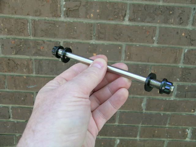

When you do decide to get your head studs replaced, I'd recommend a set of these...
ARP 911 stud kit. Pretty much bulletproof. Around $650.

Take Bill's advice or park it. Here is the 2.7 Daughter Project engine I am working on now. Pulled studs. Note the head is beat to death and beyond repair because the remaining studs would not hold it down. Also the cylinder is beat to death and beyond repair. Once one goes, it increases the load on the others and combustion pressure starts blowing by destroying things as you go.
If this engine had been repaired sooner, the costs of the rebuild would be much less. Drive it if you must but IMHO you are making a huge mistake
