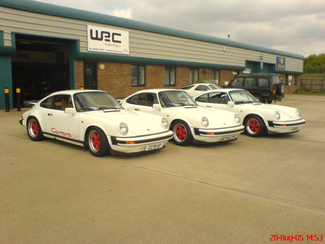

sp_cs 11-07-2008 02:11 PM
Remember my old CS well (centre) - TomT, that's Steve Darnells on the right
http://lh5.ggpht.com/_pCNTLPtNkU8/Rf...ture%20025.jpg
TomTurtle 11-07-2008 02:54 PM
Thanks for the props Jorian! Wish I could drive it some more; the 914 turbo gets most of my attention nowadays!
Nice piccie Shirish!
Steve had his car on the market for a while but eventually "saw the light" and kept it.
