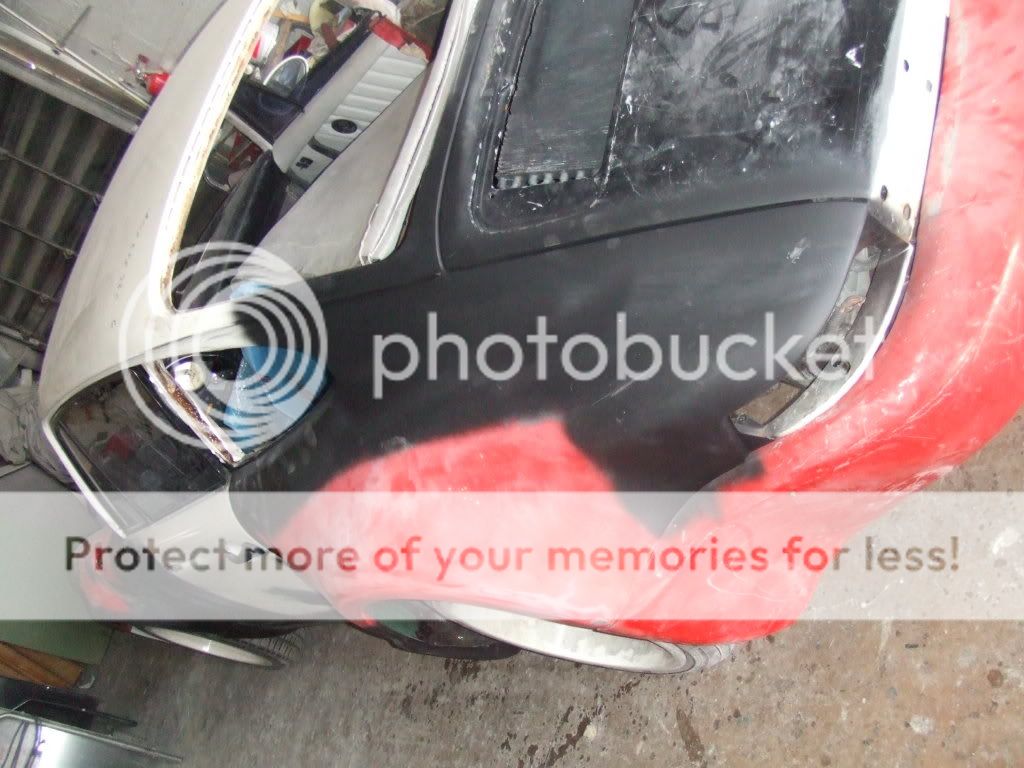

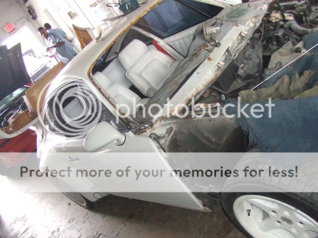

i'm doing one as we speak....alot of work and $$
