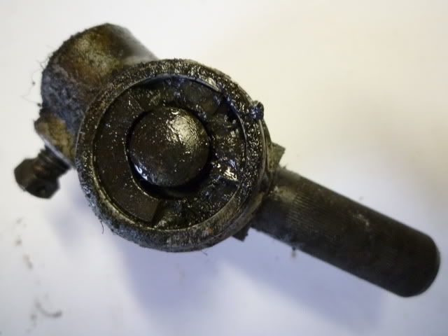

I rebuilt the Shift coupler using Superpro bushings, and couldn't resist seeing what it was like. I had a feeling that the shift coupler on my Red 912 wasn't in the best shape, and I wasn't diappointed...
Inner part of the bushing was missing...
http://i161.photobucket.com/albums/t...1/P1060716.jpg
Alot of play, front to back, side to side...
http://i161.photobucket.com/albums/t...1/P1060718.jpg
Fitting the rebuilt Shift coupler into the Red car was straight forward...
http://i161.photobucket.com/albums/t...1/P1060721.jpg
I had measured how far the original Shift coupler was inside the socket, though had forgotten about the spline rotation....needless to say I reversed out of the garage ok, however going into first I still went backwards :eek: I couldn't find 2nd and 4th felt like 1st.
Afew adjustments later, though I think it was more luck than skill, and it was sorted. The difference in shifting is amazing, much more solid and direct. Great upgrade, just make sure to measure and mark its current position before removing :rolleyes:
