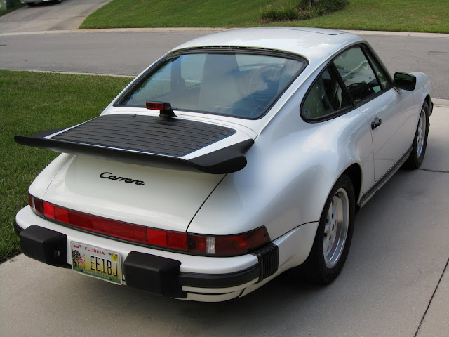

I own an '87 Carrera 3.2 Coupe (build date 2/87) with front and rear factory spoilers (smile & decklid). Over the years of admiring and shopping for my first 911, I noticed that the '84-89 Carreras have two or three variations of the 3rd brake lamp:
1) The "War Of The Worlds" (or "Cyclops") style -- mounted externally at the top of the factory-installed tail. My car has this style which is specified on the window sticker that I have in my records file (see photo below).

What combination of Production Date (i.e., production year / month), 911 Model (i.e., Coupe, Targa, Cabriolet), and Factory Options / Option Packages determined the style of factory-installed 3rd brake lamp (U.S. Spec, in particular)?
I have been confused because I have seen later model Carrera 3.2s with and without the decklid spoiler that have the 3rd brake lamp either externally or internally.

I'm surprised no one has answered, so here's my understanding.
The center mount taillight became mandatory in the US starting with the 1986 model year.
So, 1985 and earlier had none.
Cabriolets - that's easy, the 1986 through 1989 Cabs all had the "ET" style third brake light.
For coupes and targas, general rules:
1986 - Came with the third brake light on the inside of the car, on the rear glass, in the UPPER location.
1987. For some reason, Porsche located the light to the LOWER interior location for this year only.
1988-89 - it was moved back to the upper location.
But there does seem to be some issue, from what I've seen, on cars that came with spoilers, either as options on the Carreras, or standard on the Turbo. I've seen spoilered 86-89 cars with the light on the glass (in the locations above, depending on year), OR with the "ET" external one, and nothing in the glass. It seems like they did both, randomly.

It seems, and this is only a guess, that '87 was an oddball year, the only one with the internal light mounted on the bottom of the inside window, and it seems like 1987 cars that came with spoilers (either factory spoilers on the Carrera or standard on the Turbo) had the "ET" style light.
The other years spoilered cars seem to come with the internal, upper mounted light.
Maybe the 1987 lower mounted light was too low to pass regs, so they needed the ET light? But then when they moved back to the upper one for 88/89, they could standardize all 911/930 to run that one, with no external ET light.

Two different "ET" lights were also used:
Third brake light- external without spoiler------911 631 071 00--- 86-89' (this one is a little shorter than the other one.)
Third brake light- external with spoiler----------911 631 072 00----86-89'
Three different internal lights
Third brake light- inside, upper------------------ 911 631 070 00 01C----86-87'
Third brake light- Coupe, inside lower----------911 631 080 00---------87-89'
Third brake light- Targa, inside lower----------- 911 631 070 01 ---------87-89'
