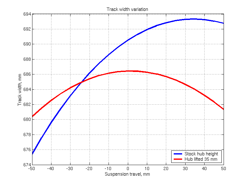

Originally Posted by 911st View Post
I am thinking that we can get the most neg camber up front we need the A arms level to the track during a full on turn. This pushes the bottom of the strut out the farthest from the car center as is possable.
Dose this make sense?
You get maximum camber when the wishbones are at a 90 degree angle to the strut. Since the strut is leaning in about 11 degrees (IRC) relative to the vertical, the wishbone should actually point the same 11 degrees up from the horizontal.
Below is a graph showing track width variation versus suspension travel relative to the centerline of the car. For both setups the distance from the ground to the rear center of rotation for the wishbone is 135 mm. On the stock setup the wishbone point up quite a lot, and with the 35 mm lifted hub the angle is quite close to the 11 degrees.
/Peter

I am starting to get what you are saying about the wishbone relative to the strut angle. A right angle might make for the widest wheel base.
However, if I read the graph right the widest track on a stock car is about +35mm above your test height. For the raised hub it is right at your test height. This has me confused???
I suspect it is important to know the test height of 135mm but one also needs to know the ball-joint centerline or wheel center height to be able to transfer that to another car. My tires are 25" tall nominal. Someone else might be running 24" tall tires or something.
That must be why the factory uses the torsion bar center line less the center if the wheel delta.
Still learning. Thanks.
What happens when you lift the hub is that the wheel end of the wishbone is lowered. Which is why the max track width of the stock setup is 35 mm higher than for the lifted setup. That I happened to hit the max track width at rest was more a lucky shot than skill I'm afraid. I wanted to lift the hub even more but was afraid the ball joint in the wishbone would hit the wheel.
I use Michelin Pilot Sport Cup in size 225/45 R17 which, according to Michelin, are 642 mm in diameter. You are obviously right that the way Porsche does it is more correct.

Peter,
Again, great info that is right at the heart of what I am trying to learn.
Your tire size is about 5mm taller than my tire or about 2.5mm at the wheel center. Not a big difference.
Looking at your graph I want to conclude that we do not want to go past the peak of the curves on compression in a full on corner or I will start to loose camber.
Is the peak of the curves the point of the widest wheel base?
If so, my stock suspension compresses about 35 to 40mm in a full on turn so I think I want to be set up about that much above the graph peaks to achieve the most neg camber I can.
Peter,
As a double check, can you tell me what your fender lip is from the ground?
Thank's big.
For a while I thought there was something wrong with my model. Intuitively the track width variation and the camber change should peak at the same point in suspension movement. Which my model shows that they don't. Now I've done the calculations in two different ways, and they both produce the same result. Therefore I believe that the model is correct. The reason why the camber and track width curves peak at different points is that the track width is measured relative to a ground plane which moves relative to the car.
Anyway, the important thing is that you have an increase of negative camber during compression, which is the case for the solid red and green lines in the below diagram.
In the track width diagram the peaks are the points of max track width, but the track width change is not that important.

Peter, thank you for you help.
You emailed me the following:
"The "at rest height" is measured relative to the distance between the ground and the center of the rear wishbone bearing. That distance was 135 mm. It is the same point that Porsche uses, I just didn't bother with the complete equation that they use.
The front wheels I use are Michelin Pilot Sport Cup in size 225/45 R17, which according to Michelin measure 642 mm in diameter."
With this and the info in this post I think I can conclude the ideal front height to achieve max neg camber in a turn.
I have to go back and redo and check my thoughts but I think setting the inner wishbone hinge about .9"lower than the center line of the ball joint will allow the wishbone or A arm to approach a right angle to the strut under a full G turn on a stock 3.2 Carrera. At that point the inner a arm hinge will be about 1.8" below the center line of the ball joint.
I think I had difficulty matching my work with the low point on the graphs.

If you move the hinge axis of the A-arm down relative to the lower ball joint, the effective control arm length will peak earlier under compression. The maximum negative camber will therefore come earlier and once past that maximum effective control arm length, you loose camber.
If you lower the A-arm axis down, you also have to make sure you do not have binding of the lower ball joint under compression because you are pre-stressing the bearing in side load- the ball joint pin is not vertical under equilibrium ride height. This may cause accelerated wear.

I am trying to discover at what point the wheel base is as wide as it will get given about a 4 deg tilt of a stock suspension car. The strut is about 10 to 11 deg from a Right angle to the ground. The distance from the center of the car to the A arm hinge is 13", and the distance from the hinge to the ball joint is 10.75".
I am told the widest track is when the a arm is at a Right angle to the strut. I thought it was when the a arm was parallel to the ground but see that is not correct.
I think the car leans about 4 deg (spring & tire compression) and I think the a arm gains about 5 deg of angle with this.
How do we calculate the height to set the car at for the most neg camber?
The good news is if we are wrong a little the camber curve is very flat 10mm to each side of the ideal.

Maximum track width should happen when the A-arm is level to the ground. The maximum negative camber will occur when the A-arm is perpendicular to the strut. The strut is not vertical, of course, so the maximum track width should occur before the maximum negative camber when going through compressive suspension travel (jounce- both wheels moving together).
This effect is offset somewhat by the negative camber gain. If you account for the height of the wheel/tire assembly, then the sine of the angle of A-arm deflection times the wheel/tire radius will be added to the track width. if the radius of the wheel/tire is greater than the length of the A-arm (I think), then the camber gain will add to the track even as the A-arm is compressed beyond level.
This effect under compression is countered by an opposite camber curve and track width narrowing on the inside tire/wheel in rebound. This means that the track width variation should be quite small. However, the camber gain on the outside, loaded wheel should rule. Also, stiffly sprung 911s lift the inside wheel so there is no more suspension travel and the 2 sides diverge in the geometric changes. But that does not matter when the tire is not on the ground.
Stiff springs are probably the easiest thing to do. Lower the car and lock it down like a go-kart.
The easiest way is to start with the solid blue curve in the camber gain diagram I posted earlier. If you haven't touched your suspension struts that is how the camber curve should look on your car. If you assume that the front strut will compress up to 40 mm you should maybe use a distance between the ground and the center of the rear wishbone pickup point of 155 mm. That is 20 mm more than I use on my car, and will result in a curve looking something like this:
The red line shows the effective camber when the body roll of the car is taken into account. There you see that if you compress the outer strut by 40 mm you will have about 1.5 degrees of positive camber on your outer wheel. This is about as good as it gets. If you want to reduce the effective camber more you need stiffer springs and anti roll bars.
Please keep in mind that this is not an absolute science. These cars were assembled by hand therefore one is not exactly like the other. In addition there is some compliance in the suspension bushings, and a certain amount of flexibility in the struts. Therefore; the above diagram is not the exact truth, but a simplified model of it. It serves as a good starting point for experimentation.

As the a arm moves past parallel to the ground it keeps pushing the bottom of the strut out making the track wider. Thus, most static neg camber is going to be at the same point the wheel base is at it's widest point. I wish to set my car up high enough it will be at the point in a full on turn.
Peter,
Did you adjust your scale to match setting the car up at 155mm?
Where are you measuring travel? Is it the amount of strut compression, at the fender lip, at the torsion bar, or? 20mm at the spring is like 40mm at the fender.
Also, you tires are .3" taller than mine. Do I take half that off your measurement.
Yes, I want my car to be close to the mark you placed on the blue line line. So you are saying if it put the CL of my torsion bar at 155 I should be close to spot on for my goal.
Worth noting is that the camber curve is very flat to both side so some error or added compression with bumps will not make for any issue.
Peter,
The diagram is made for 155 mm distance.
The travel is the movement of the wishbone pickup point relative to the ground. So -50 mm travel equals a distance between the pickup point and the ground of 105 mm.
This is great!
The diagram is just a simplified model, and as you mention; the curve is quite flat, so I wouldn't really bother with the half 0.3".
You can go lower than 155 mm, but I wouldn't go a lot lower.

Number, number, more numbers.
(please see last post.
Porsche specs front height as the difference between the wheel hub center and the torsion bar center at 108mm +/- 5mm.
Peter, using the info you gave me as to tire type I belive your wheel center is at 314mm and you say your TB center is 135mm for a difference of 178mm. That is 70mm (135-108) or 2.77" lower than factory 73 911S spec if I am correct.
My car measures 310mm/145mm or 165mm difference. Thus I am about 57mm ( 178-108) or 2.25" lower than stock.
You say I shold start 20mm higher than you. You are at a 178mm wheel center to TB center of 178. If correct, I should be at 178-20 or at 158. However, I am at a 165mm difference. Thus, I should rase my car If so, I should rase my car up 7mm or 1/4".
Using arm lengths and angle changes that is very close to what I thought for a car that leans 4 deg.
Good news is the curve is very flat in that area and dose not effect neg camber much.
Concludion, on a stock car the ideal setting to achive max neg camber in a full on turn is a setting of about 158mm (6.25") difference between wheel center and torsion bar center!!!
This is a better measurement as some people use tires as small as 23" in diameter on a car that mostly cam with a 25" wheel.

The travel is the movement of the wishbone pickup point relative to the ground. /Peter
Apples and Oranges?
We may have an error in our work. If we are using 40mm movement at the torsion bar center as the amount of compression or movement with a full on turn on a stock suspension 911 we may be using bad info?
If a stock car leans 4 deg (per Burgermister) and we assume the center of the bottom of the pan is the point of rotation, I do not think we would see the 35-40.
I think movement at the torsion bar center is going to be about 23mm (.91"). At the fender it would be 53mm (2") and at the wheel center it would be 42mm (1.7") if my calculations are correct.
Using angles instead, I think that when the TB center is about 1.8" lower than the ball joint center the a arm will be at or close to a righ angle to the strut (assumed 10deg strut angle and 10.75" a arm). Then when cornering at 4 deg car angle (5deg change in a arm angle) we would see about .9" deflection. Thus, settin the TB center .9" lower than the CL of the ball joint should get us to 1.8" in a full on turn.

I wouldn't bother with the 7 mm difference. You'll be very close to figure three in your picture.
/Peter
