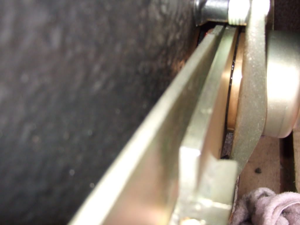

I test fitted the spring plates and covers without any torsion bars fitted, as instructed by Chuck Moreland.
I started with three washers but that bound the plate tight. I ended up needing 5 washers under each bolt, but at that the plate moves without any force and has a little lateral movement.
The only problem is having used 20 of the 32 washers, I will probably have to buy more if the other side needs as many as you only get 32 supplied :-(

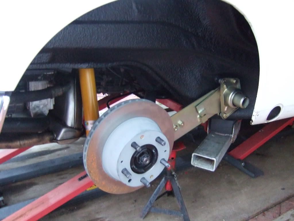

Here is a picture with it all bolted together (some minor tuning still to do)
I corresponded with Chuck Moreland (what a helpful person he is) over my concerns over the way the SAW Spring Plates can separate, as they are not physically bolted to each other.
Whilst budget says I cannot do anything now, I will certainly consider a move to different spring plates over time if I get problems with these.
