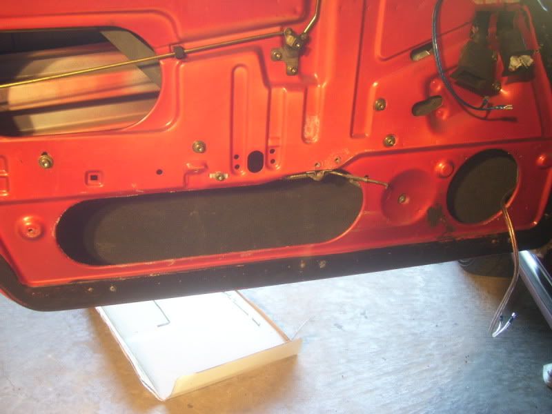

It has helped me NO PROB WITH CARPT EITHER.http://forums.pelicanparts.com/uploa...1264223131.jpg
http://forums.pelicanparts.com/uploa...1264223203.jpg

The rattle trap went on well. I used 100 sf single layer on all areas roof, sunroof included. Double in doors and on the back under the rear cover. Adhesion was great. The thickness was 80mill. Took paint well (painted roof so that it did not "shine" under liner). By cutting into little strips i was able to slip into small hollows in roof and under dash. It also cut down on air infiltration. More pics if you are interested.

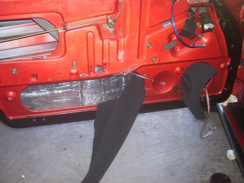

Rattle trap

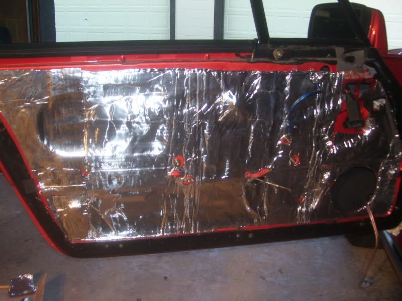

More pics, I PUT TWO LAYERS IN THE DOOR THE NEXT TIME I TAKE OFF THE PANELS I WILL ADD A LAYER WHERE THE PLASTIC FILM GOES JUST TO SEE IF IT MAKES A DIFFRENCE.(http://forums.pelicanparts.com/uploa...1264433514.jpg
http://forums.pelicanparts.com/uploa...1264433552.jpg
http://forums.pelicanparts.com/uploa...1264433606.jpg

i don't think adding that extra layer will help much with vibration reduction and certainly not with noise blocking as the only thing that really makes that panel vibrate is the speaker. it will however improve the sound of your speakers by "sealing" the door and providing an enclosure if you will for the speaker depending on how much you do. you should notice an improvement in midbass response.

i did a layer on the bottom of the inner skin first on both doors because there was just too much stuff in the way on top. this did give me almost 50% coverage on the outer skin so i was satisfied with the results. i also added a layer of overkill to help with reflecting soundwaves inside the door:
http://i15.photobucket.com/albums/a3...o/100_4578.jpg
http://i15.photobucket.com/albums/a3...o/100_4585.jpg
i then did the full layer on the inner skin on the driver's side and went for a ride. i could barely tell a minimal, if any, difference in sound reduction with my naked but trained ear. i did however have a noticable difference in the sound reproduction of my 6.5" midbass driver over the passenger side.

Yepper, in 72 they did not have the support bars. This made the install easy. I also took out the glass, frame, and other hardware. Cut the pieces into 4x12 strips and did a x overlay. I gave the original "foam" material a good look and decided that the new material was enough??? I did not take the backing off the floor portion just set it in a large section (just so i can monitor the moister) used a glue pot to shoot the carpet adhesive and both motor noise and road noise has been cut down tremendously.
