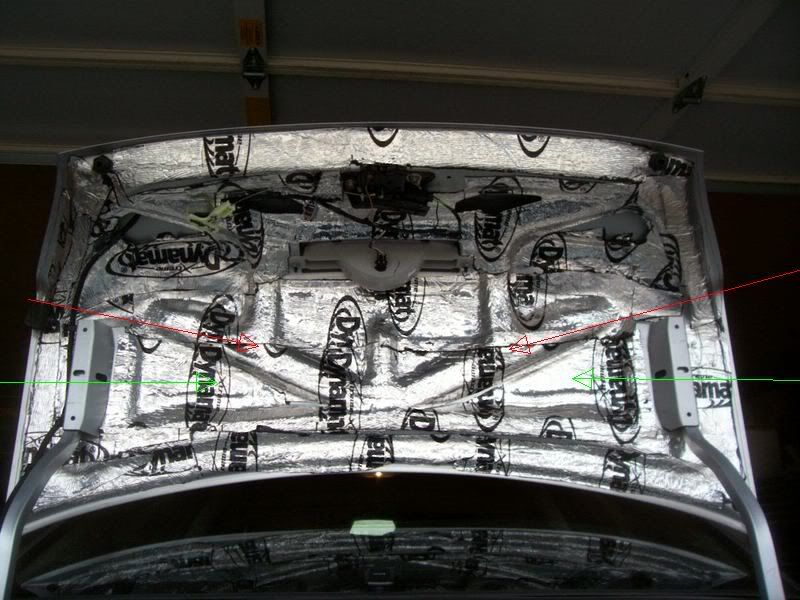

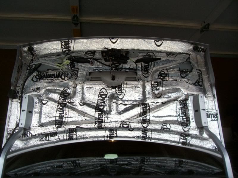

damplifier, damp pro, dynamat and similar cld products are vibration dampers not noise blockers. their job is to reduce vibration in large sheets of metal, and while most quality products achieve this goal the end user hears less noise and thinks that they are blocking noise as well. most people, like cliff and myself, were misinformed over the years as to it's intended use and application methods. in one of my cars i applied dynamat xtreme just as he did.
in reality you only need to cover the panels that will resonate from road vibrations instead of a layer over everything. that really comes down to just the large, flat areas of metal. places that have bends or a pattern, if you will, of raised portions, will not have the same acoustical qualities and can be left on their own. a perfect example of this is a modern trunklid. here is a shot of the one i did for example.
i covered the entire lid when all i really needed to do would be the triangle shaped parts. the green arrows below are what needed to be covered and the red arrows point to what would have been fine on it's own.
i have spoken with the guys at SSA as well as a few other companies and they really seem to know their stuff. their products were designed to be used in a car, and if applied properly they do their job well. if noise reduction is your final goal you can't simply just slap some cld and call it a day as that is not the purpose of cld. you really need to add something on top of it like luxury liner or heatwave. these are the items that need to be a blanket if you will and cover everything, including having their seams sealed. these are the noise blockers/absorbers and when applied correctly really do their job well. one without the other will work to a point but when used in conjustion they really perform well.

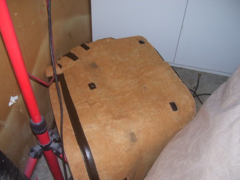

that is why i suggested that if using 2 materials you do not get the "pro" version. i spoke with ssa and they have had a lot of 911-related questions. their best solution would be to use damplifier and then heatwave on the rear seats and then damp/luxury liner on the floors. the heatwave is not as good as the luxury liner at reducing/absorbing noise but it is better at dealing with heat.
i recently did the rear parcel shelf and upper seat backs with damp pro and some closed cell foam i had left over. the foam was not the best solution to my "problem" but i had some on hand and didn't want to throw it out. once both were installed i had no problems putting the parcel shelf cover back on. since this area will see the most "noise" from the engine and has lots of flat metal area i covered the whole thing.
this is the factory piece i removed and then reinstalled with no problems. it is the thick rubber with a thick insulation-like material under. the insulation can easily be compressed so it was not a problem.
