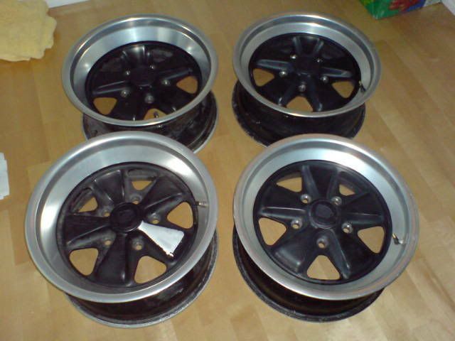

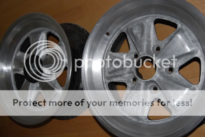

Basis for the makeover. 7J16" ET23,3, 8J16" ET10,6 from a -81 930

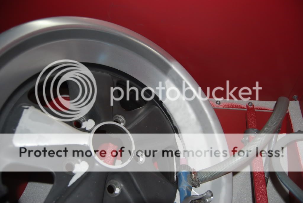

First job was to remove eloxated coating in a glass media blaster.
Here is one blastered and one untouched.
Next few steps was to water sand the lip with grid 240 - 400 - 800 and ending with 1200 paper:
Then the lip was polished with aluminium polishing paste and cotton pad:
Next step was to mask up the polished lip and prime with a 2K primer:

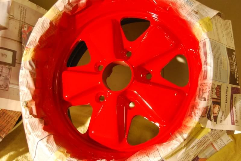

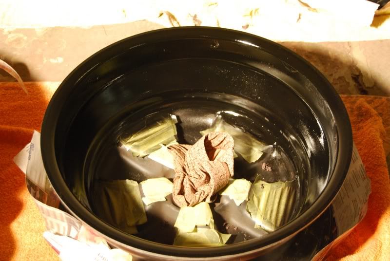

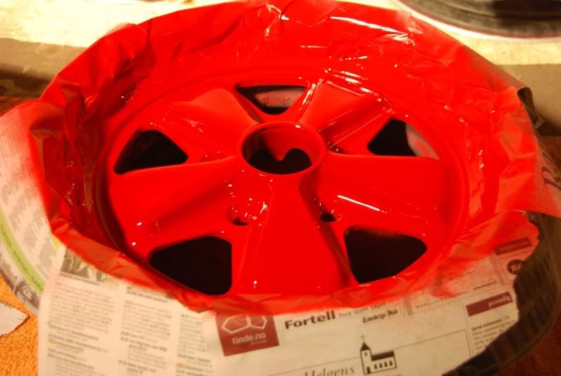

Part Two :-)
A nice coating of Guards red base paint to match the überwagen:
A even nicer coating with 2K clear paint:
Some black paint on the back:
The most exciting job at the end was removal of tape and newspapers:
Four finished old timer Fuchs wheels in custom coloration:

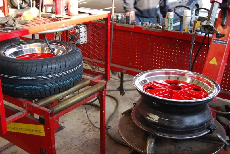

New Continental SportContact N1 tyres mounted:
Fitted to the 911 - The finished result was just as ordered The same operation was done to the center caps and the wheels got twenty new lightweight nuts:

Originally Posted by Hotwatermusic View Post
Very nice! Just a word of warning though, the people on the group are going to eat you ALIVE for painting the lug nut holes. Just letting you know beforehand....
The lug nut holes is grinded to bare metal - No need to eat me alive

Nice job what size rubber did you put on? I have a set of 8 & 9's and am interested in new tyres.

Continental SportContact N1 tyres Front: 205/55/16 Rear: 225/50/16

Did the bead blaster remove the protective anodize layer?
Old 01-15-2010, 01:52 PM
Fastracer73's Avatar
Join Date: Jan 2010
Location: Norway
Posts: 50
Yes - with fine glass beads. The glass will not harm the aluminium surface.

They look good, however if the hardened anodize is removed then they will dent pit and scratch very very easily.Without the anodize forged aluminium is like butter and will not last..
Old 01-15-2010, 06:27 PM
Join Date: Jan 2010
Location: Norway
Posts: 50
You'll have to polish the lip reguarly with "auto glym - metal polish" or similar products. The aluminium is no more "butter" than when anodized. The early Fuchs came also in neutral aluminium from Porsche originally.
So naked aluminium needs more TLC than the matt anodization If you clearcoat, chrome or paint aluminium - the layer put on will sooner or later peel of when the layer gets punctured (because of the aluminium's oxidation speed). The anodization will not, just get worn off and get misscolored.
So no concerns - naked polished aluminium works just fine for Fuchs, BBS, O.Z, Zuffenhausen, Lindsey, Alton +++++
