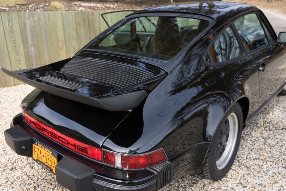

737aviator 06-02-2014 07:13 PM
http://forums.pelicanparts.com/uploa...1401761353.jpg
I thought for a long time that this whale tail was an after marker item. From several treads on this formum I have since located part numbers. The car is a 1980 911sc purchased in Europe. I think I am the third owner. Still looking for the small grill as the one that is in there is not correct.

How about some better pictures of this tail? Rubber doesn't look usual but not sure what it is.

737aviator 06-03-2014 04:50 AM
Whale tail rubber
I am reposting this thread from another location on the forum. I have lost that location but here is a statement from one of the forum participants concerning the different rubber on the whale tail of my car.
John,
I'm glad you finally posted pictures of the tail, as it is quite unique, and one that has never been documented in any books or magazine that I have seen!
It has the 'main body' structure of the '76-'77 Turbo tail, but the rubber is more blunt ... I presume to meet German govt. restrictions when appendages started appearing on 911s in the mid '70s. Reports of the RS 3.0 being shipped with two tails, one specific for German consumption -- and the other to satisfy esthetics and aerodynamic wishes of the engineers ... surfaced in October 1974 when Paul Frere wrote in Road & Track about the overpriced $25K wonder!
But, pictures of the 'ugly tail,' pedestrian-friendly variant NEVER SURFACED!!! I guess I understand why, now! I guess I just never understood why some govt. beaurocrats became fixated on hood ornaments and tails as dangers to pedestrians ... when it was the mass of the object carrying them that kills pedestrians when struck, not how sharp or pointed various trim items might be!
Perhaps Roland can enlighten us about the 'ugly tail?' Sorry, but I don't think that tail has much value, except as documentation of German Govt. beaurocratic excesses via meaningless regs!
javadog 06-03-2014 04:57 AM
It looks like somebody has installed a 3.3 turbo tail rubber onto a 3.0 turbo tail.
JR
