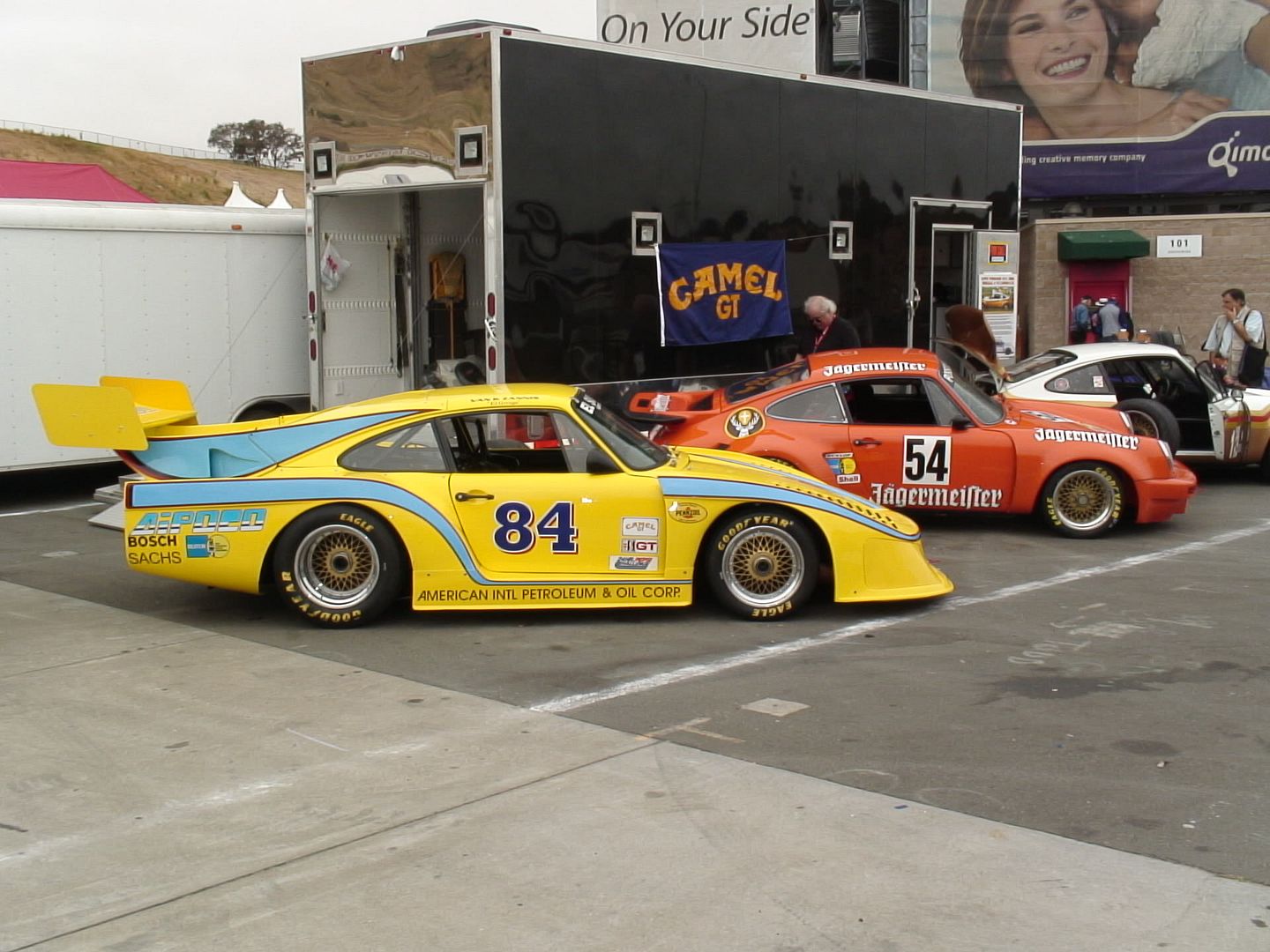

However if memory serves me my friend JB who owns the real 1974 Jagermeister RSR pictured here with my 935 ... his wing has the same rubber as the 934 wing.
http://img.photobucket.com/albums/v6...7/DSC04647.jpg
