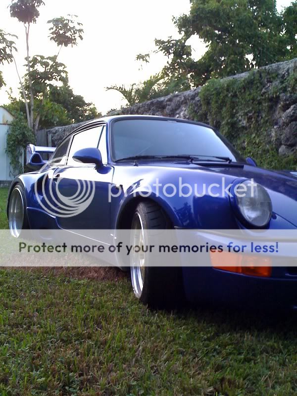

Mia911's Avatar
Join Date: Oct 2008
Location: Miami Florida
Posts: 459
well mines is super wide im running like 18x13 in the rear...my wheels was special order for my car.....

Old 01-08-2010, 11:23 AM
Crotchety Old Bastard
RarlyL8's Avatar
Join Date: Jan 2000
Location: Huntsville, AL
Posts: 15,025
Interesting car but those aren't stock 11" flairs, the rims stick out past the lip of the flair and the tires are more narrow than the rim. Not what most would consider a standard fit.
On a standard widebody 911 you have 13" from the inner wheel well to the outer flair lip. That is 12" max on the wheel being slammed against the spring plate. Modification on the passenger's side and added camber are needed to allow for suspension travel.
