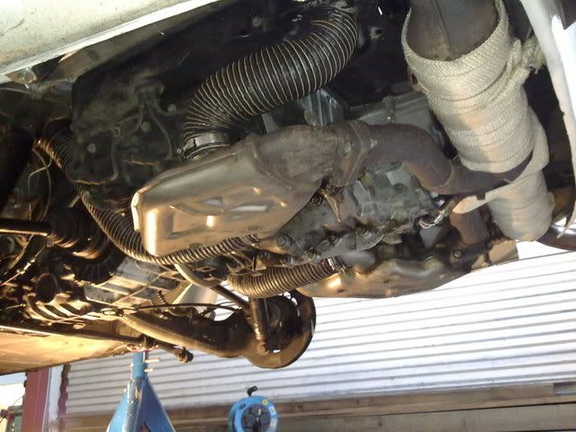

Jaskas 08-29-2010 10:59 PM
Originally Posted by rfloz (Post 5521745)
super9064 - IMO the Supertraps sound pretty crappy. You might want to listen to someone's car that has them before committing.
+1
I´m trying to fit some small extra mufflers to my system. If i only get them to fit under the car somehow
This is my setup at the moment:
http://i216.photobucket.com/albums/c...s/IMG_6269.jpg
http://i216.photobucket.com/albums/c...9042010128.jpg
Sometimes i put on the supertrapps, when i get tired of the noice, or the girlfriend want´s to borrow the car.
