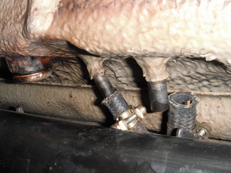

Old 03-16-2012, 09:58 AM
Join Date: Dec 2004
Location: So. Cal.
Posts: 576
couple more pics
Tank lines and lines entering the tunnel. I think the exit from the tunnel is really tight. Can't see how it's possible to flare while it's in the car.......
