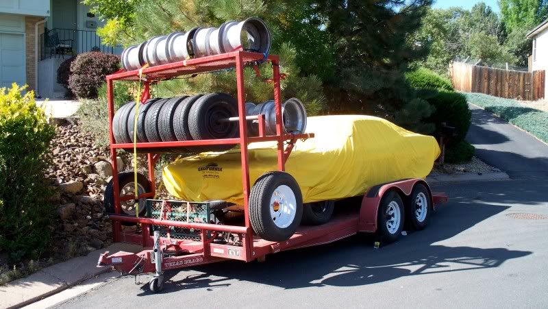

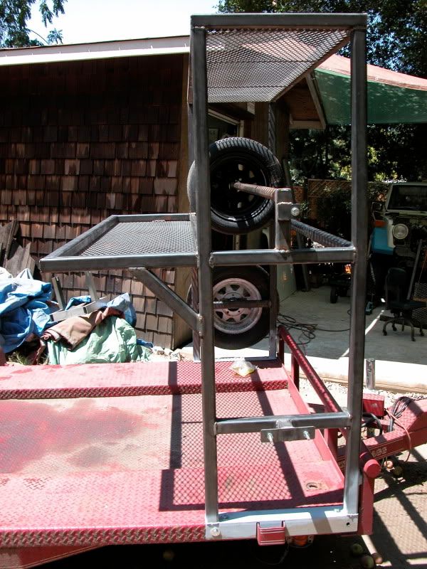

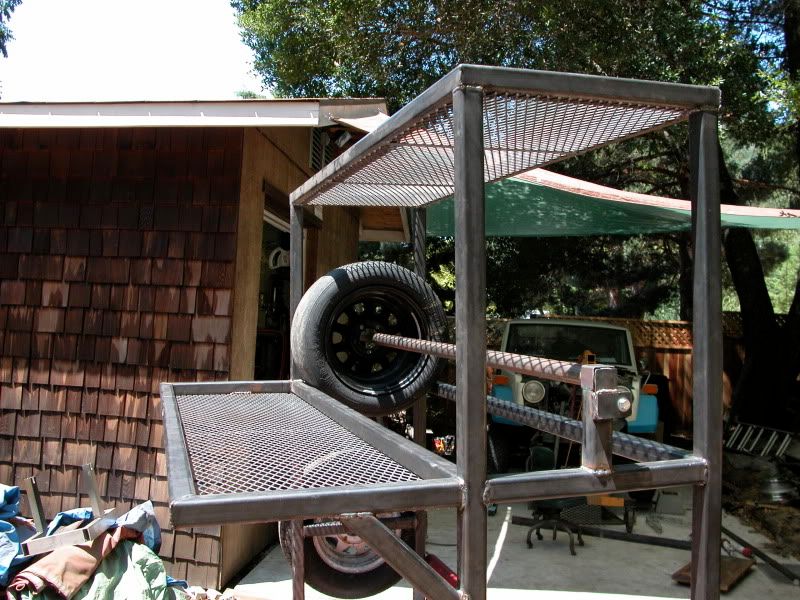

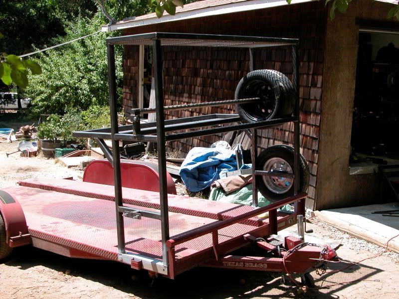

Built this for a customer:
All measurements were for his car, your mileage may vary. The rack over the hood is for coolers, chairs and whatnot. The top of the rack will hold whatever also, expanded steel for decking.
eric
