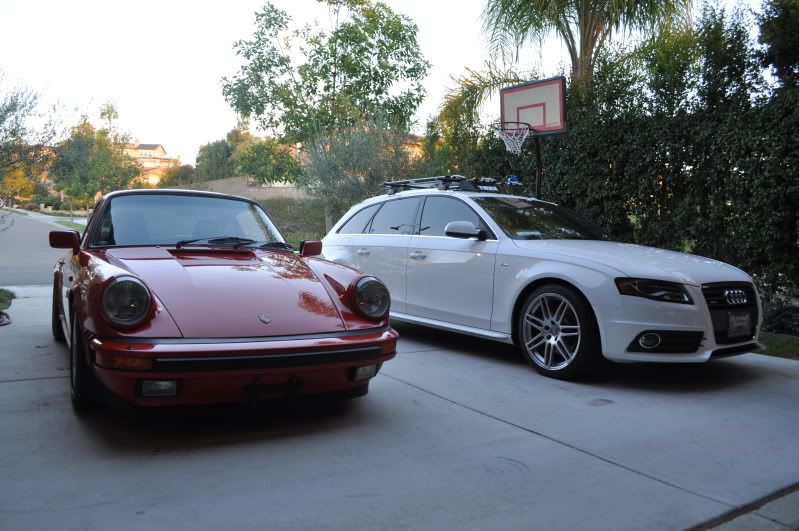

On to the details of my new car. It is an 85' Euro car Guards Red (original paint) over black, sport seats, lowered, 7's and 9's, Steve Wong chip and a Dansk exhaust with 88K miles under two owners. I love the car already, but think there might be a transmission rebuild in my near future (grinding going into first unless completely stopped and stiff going into second). Car had a dyno this year and was producing 207 HP at the wheels. On to the pictures!
It is funny how big this makes my M3 and A4 look in comparison. Makes me realize how big even "entry level" cars have gotten in the last 25 years. My Avant looks like a Suburban next to it. Anyways, I look forward to learning a lot and being here for a long time. Any questions just let me know.

They certainly look a little on the small side these days. I swear when I see one on the road they don't have the exact presence as they used to because of this. Guess a wide-body and whale tail would help...

Nice Euro.
If you can learn to massage that 915 it has lots of life left. Change the fluid and put in my favorite 915 fluid, Kendall MS-NP, and shift 1-2 at 4K RPM. The first gear issue is just the way many of the 915's are these days. My '86 is an urban daily driver and I have just learned to drive in such a way that I don't go into 1st unless stopped. It is easier than it sounds and becomes second nature. You could spend the money on the rebuild and it still won't feel modern. Change fluid first and if that doesn't do it for you, rebuild it.
I would raise the car just a tad. You will kill the front spoiler, AC condenser, and rear sway bar at that height. Looks like the front spoiler has already taken a few digs.

I kinda like the diminutive size of my 911. Heck, it makes my garage seem bigger when it's parked inside!

Smaller means lighter. Lighter means faster.
Cars today are ridiculous, too much weight. This is why old 911s are still fast on track even when compared to new models.

Great looking car, rides on the low side but that's cool.

I love the size of the car. Makes me feel like I am driving a go kart on the street!

Nice non-sunroof coupe. The small size and light weight compared to new cars is what makes them so agile. The manual steering is another part of that great road feel. The car looks great but I agree that you should probably raise it a tad to avoid bottoming out the suspension which can result in scary snap changes in cornering dynamics, aside from the extra scrapes the body gets on the street.

Killer 911 you have there. The stance is bada$$ but maybe not practical?
No matter, it looks sweet!!
