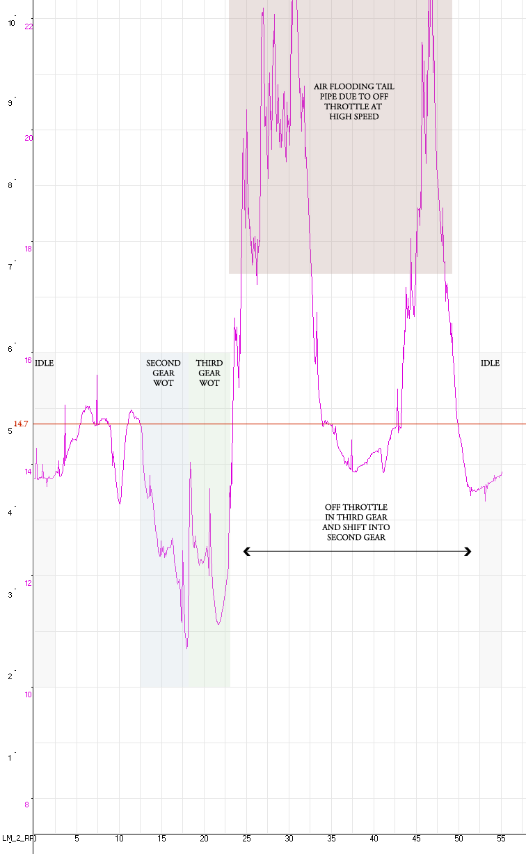

Here is a graph of my AFRs. I only did one run because I ran out of time on Saturday. It took me half the day to update the firmware on the damn thing. What a pita.
My idle AFR was 13.7 ... not running O2 sensor. You can see that I get into the low 11s at WOT. You will see some very lean conditions off throttle. From what I've read, this is due to air rushing up into the tailpipe. I don't think a car could run at at AFR of 20. If you use the LM2 on a dyno you won't see this kind of bad data.
Oh, and the RPM clamp seems like a pain unless you are using it on a dyno. The cord is only like 4 feet long.
