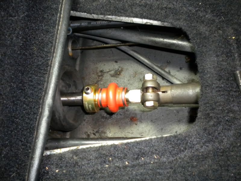

Hey,

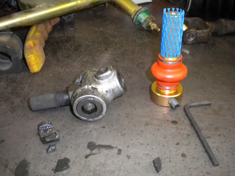

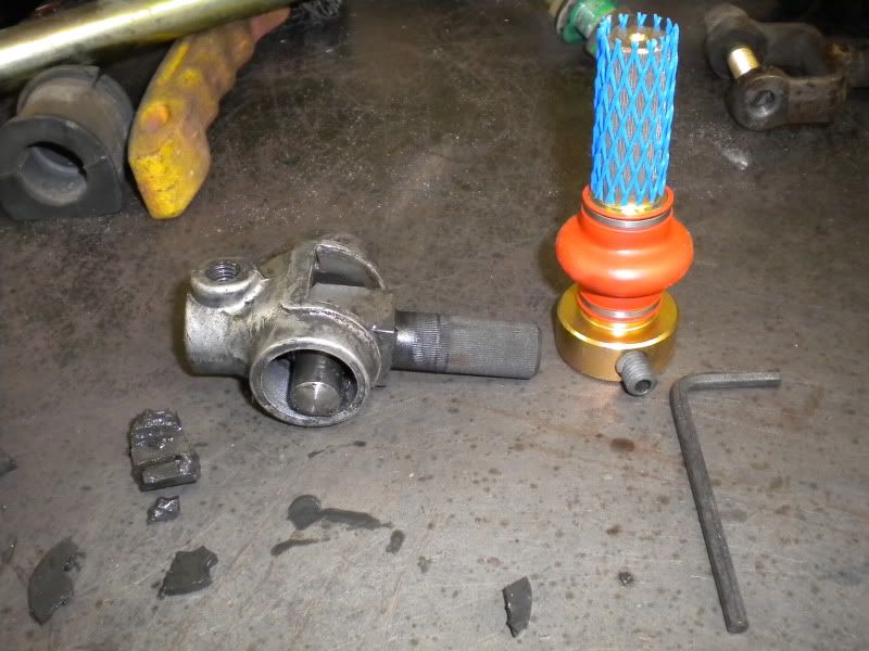

I have been chronicling my adventures in Pcar ownership of the MidYear that no one wanted. I have been having issues getting 3rd gear when the car is loaded up in braking or coming out of a corner. I know, I know, what can I say, I like trail braking and and doing goofy stuff just to see the cars reaction. Well I decided that after the Seine Systems Gate shifter the next to last leg would be to replace the shift coupler with a more positive replacement, a Stomski Precision shift coupler! You might be amused at the condition of my OEM coupler bushings:
The other side:
Coupler installed:
I know the boot is missing, the entire job took only 3 hours, about 45 minutes to replace the coupler, and 2 hours of playing GTA Vegas on HYW 9. I was going stupid fast, loading the chassis trying the coupler, shifting under load when I came up on a Viper, he saw me coming fast and pulled over. Thanks buddy, I hit into overtime GTA mode and started running through the gears, he could close on the straights but the Pcar would embarrass him in the corners, lost him easily going uphill, home court advantage! He pulled up at the stop sign and was amazed that a Porsche that old made him look like he was driving a mini van. MMMMNNN Viper for lunch, tastes like chicken!
BAAAHAAAA
eric
P.S. I marked the coupler position and put the boot back on, its easier to fine tune the coupler position without the boot on. Everything all buttoned up and my shifting is better than all my previous Japanese Cars!

The Seine makes it more difficult to go to an unwanted gear, ie 5th to 2nd instead of 4th. The spring loading of anything other than 3rd, 4th is insurance and might add 2-3 nano seconds to the shifting process. I will add some stiffer trans and engine mounts to the mix soon enough. It is weird to no longer have any slop in the shifting linkage. Very nice addition to the car, +4 for effect and a 3.5 banana job, maybe a 3 banana job if you read some instructions!

While those universals look similar, they will require some fabrication to make them work. I have a fabrication shop in my backyard, I bought the Stomski. It is like I tell my customers, if you can buy it off the shelf it will almost always be cheaper than paying me to do it. I take my own advise, and save the fabrication time for unobtanium projects. When I look at the Stomski and others, the $200.00 is way cheaper than reinventing the wheel myself.
At any rate, I really like the improvement that the off the shelf item provided.

Draco, this mod made a tremendous change in the shifting feel of the car, And, any of the aftermarket couplers (wevo, stomski, ect) work better than a worn stock one!
