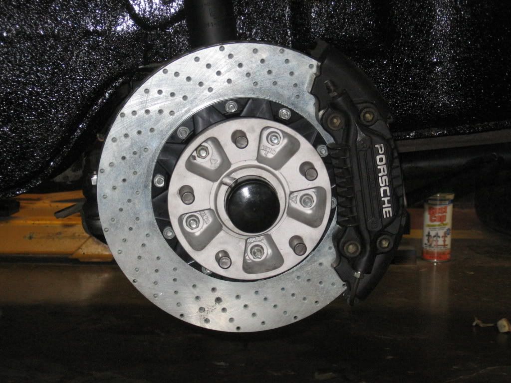

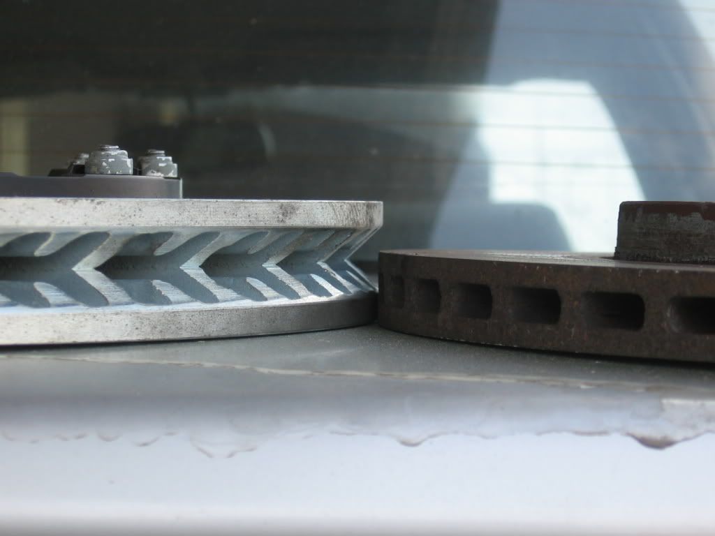

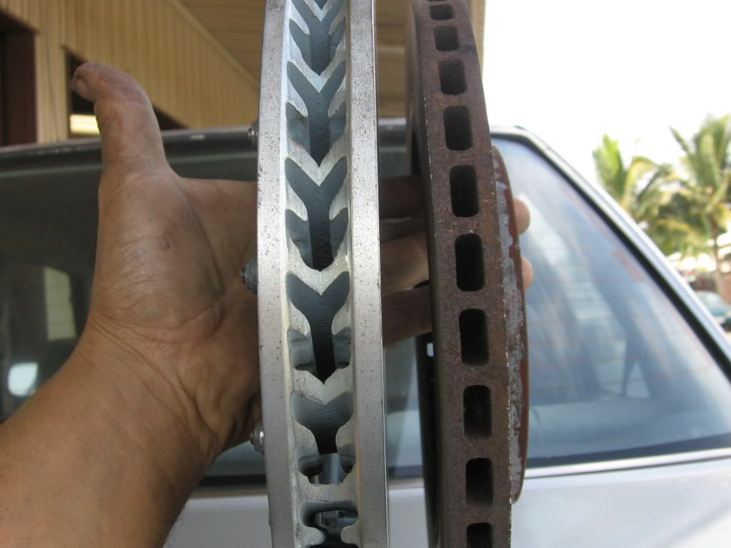

Originally Posted by Steve@Rennsport View Post
FWIW, we do make a 930 flat-hat rotor assembly that we use for fitting 930 brakes on a 911. You can see them on the Brakes page of our website. These have been quite durable on all our race cars for the past 6 years.
And they are very nice. Here they are mounted on my RS imposter:
vs. stock SC front rotor:
You will have to run a small spacer if using 16x7 "911" stamped Fuchs, or you can do what I did and use "951" stamped Fuchs from a 944 Turbo
