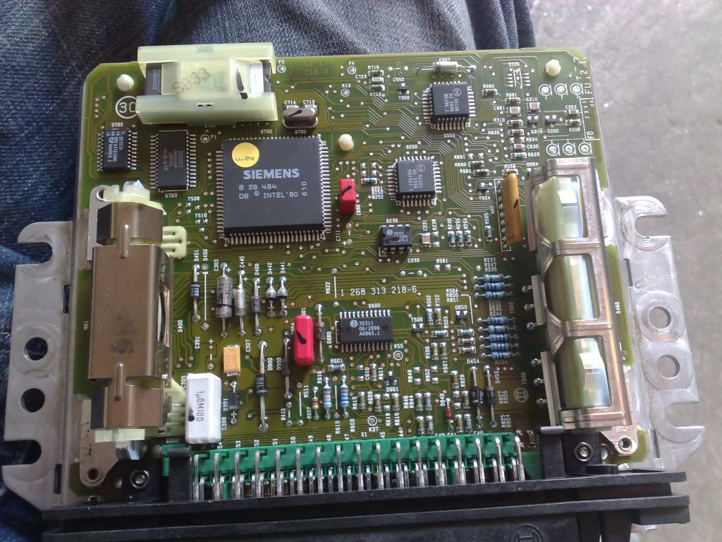

TIP and manual were different in the DME harness (backup light signal) but the DME is identical. There is a coding jumper close to the 55-pin connector that tells the DME to be for a manual or Tip car.
When selecting TIP the DME uses a different map set, a different idle speed and listens to the shift signal from the Transmission control unit. Every time the transmission shifts the DME will momentarily lower the torque output of the engine by retarding the timing.

So can i by-pass the signal with some jumper (wire) or is it in the software?
pics of the dme

The jumper is not inside the DME, it is a plastic plug with a wire loop that plugs into the DME wiring harness. The harness should have one 3-pin and one 2-pin connector branching off close (within a couple of inches) to the 55-pin connector. One is to select the maps (ROW, US) and the other is to select wether the DME is in a manual car or a Tiptronic car.
If the 2-pin plug is installed onto the 2-pin connector it codes for a Tiptronic. Left open codes for a manual transmission.

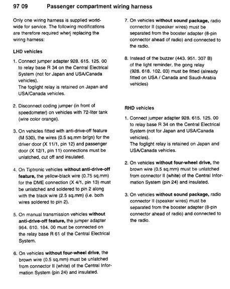

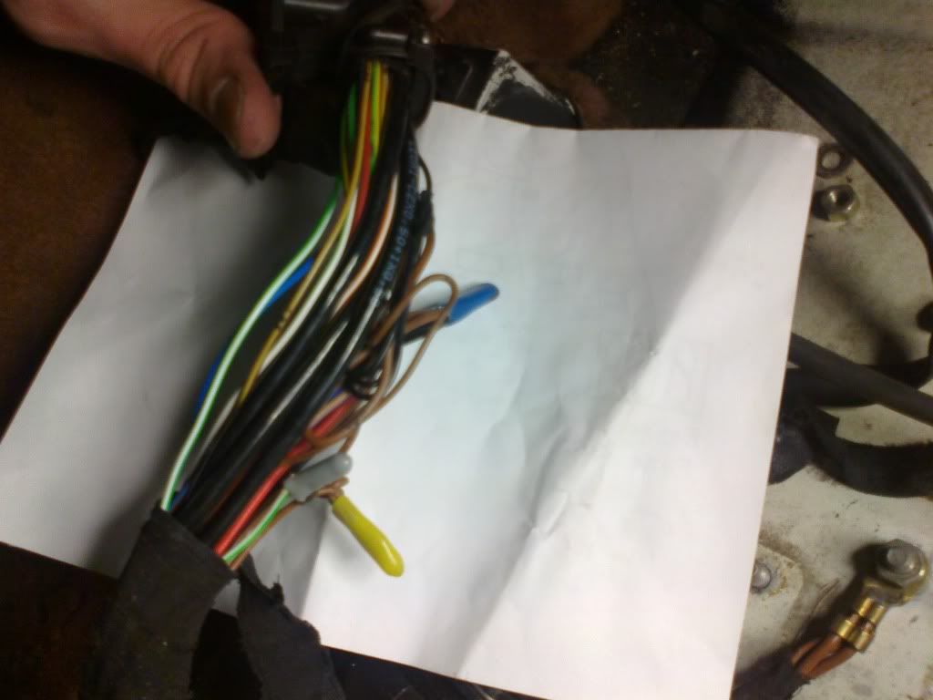

Now i had the time to dig into this issue.
I found from the manual and instruction how to wire the harness:
Are these soldering in the root of the harness somehow ralated to this issue:
The dme plug:
911-87 mit der 3.6 V-Ram und alles spaß

The pin no 42 determines the gear selection and the rpm reduction. Does it also affect to the power and torque? Do i want ground or not?
The pin no 44 is for Tip-coding. Should it be ground or what with manual transmission?
Any Ideas?

This is really a case where you would need a Hammer or PST-2 to check what the DME is "seeing". From experience all these inputs are active low. That means when nothing is connected the internal pull-up resistor makes them high and thus inactive. So my educated guess is that you don't want to connect anything to pin 44 because you don't have a tiptronic. If you select tiptronic you'll end up using different maps. When you are in stick mode configuration pin 42 is probably not even evaluated.
I would try to pull pin 40 (AC clutch) and/or 41 (over-run shutoff) to GND. This will influence the idle speed and behavior. Try experimenting with these pins and see what the engine does and if it improves idle stability.

For the problem with the idle: As the self-learning functions learned them selves enough ( after the battery was disconnected for couple of months ) the idle settles now much better. So i beleive that infact there was no fault in the system. The ECU didn´t just have the time to adapt to the parameters.
For the timing retard issue: If had the workshopmanual with me on a couple of boring flights and now i found out that in the late tiptronics the encrypted coding for time retard is only ON when the sifting or idle. So when the pin 44 doesnt get any signal the timing should be normal.
Great!
