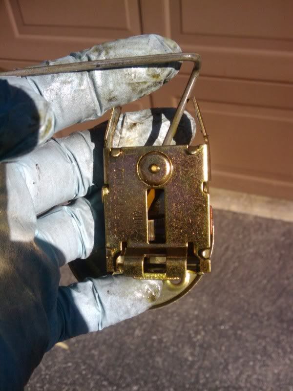

I had an extra issue where my dip stick was jamming into the Oil Level Sending Unit (OLSU). I can only deduce POS/iWrench jammed the OLSU in or out. The retaining tabs appears to have been tampered.
It was scored and severely scuffed at the shiny part of the float arm assembly:
I know it is blurry but trust me it is there and can only be produced by the end of the dip stick.

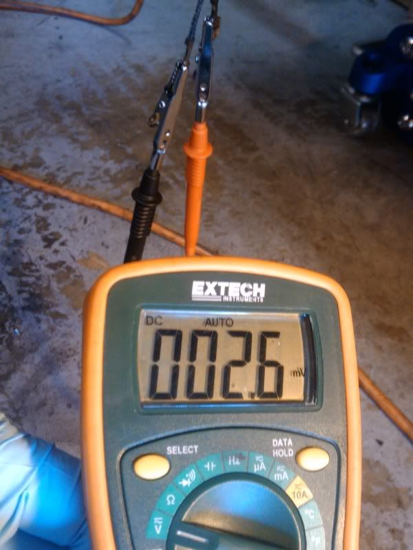

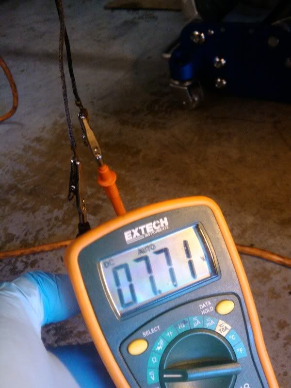

Test Gauge to insure it is not the culprit, pull ground at OLSU ( should be a female spade ), turn ignition to on position, and it should peg up. If it does not Gauge is potential failed component.
or
Get your DVM, connect Red lead to center connection on OLSU and Black lead to ground attached to one of the side bolts, these are readings I obtained:
Car Off
Car in On Position

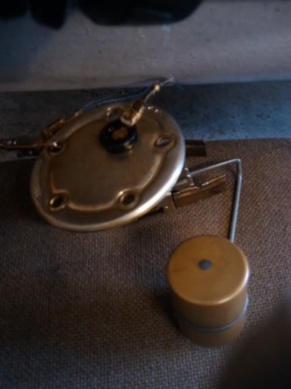

Removal of OLSU:
1. Pull both wires, the ground will be the bare female spade attached to what is the male spade under one of the 8MM nuts closest to you, the signal wire is also a female spade covered by a rubber boot at center of OLSU. (if you are lucky, mine was missing, it appeared it was worked on before by POS/iWrench that never bothered replacing it, just cut it off. Both were filthy and exposed to the elements)
2. Remove 8MM nuts and washers (3 of mine were so loose they were removed by my fingers , I don't think that is snug, I did observe some oil sweat spots prior to prep). TAKE CARE NOT TO LOSE THE MALE SPADE under that one nut/washer, you will need it!
3. I found the OLSU even with loose nuts did not budge, I even tried to gently tap on it, no go. I did not want to pry at it since I am planning on reusing it (if found to be good). I resorted to using a HEAT GUN to warm it up but not too close or the plastic center could melt. At about 140 degrees, it just peeled off and the gasket intact

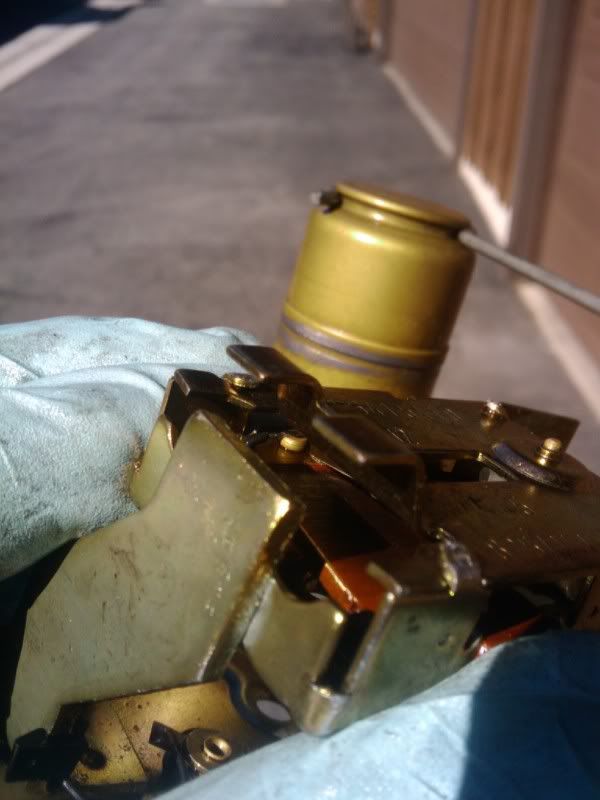

4. Now the fun begins, After looking a pics of a new OLSU, I determined that the main body needed to be out first by pivoting the plate inwards to towards the engine then rotate and carefully fish out the arm and float in a down /up motion. Lucky guess, it came out smoothly with out snagging. Set Aside
VIDEO later of how I re-inserted it
5. Stuff a CLEAN rag into the hole at the sump, not too deep or you will touch the oil and soak your rag with valuable oil.
6. Using a puddy knife, peel the old cork gasket and use brush with solvent to clean the mating surface.
Dismantle the OLSU:

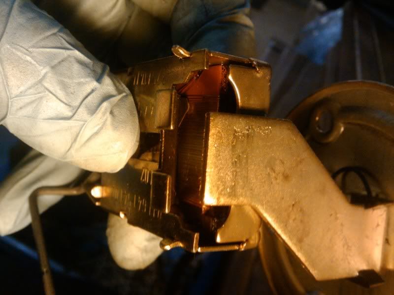

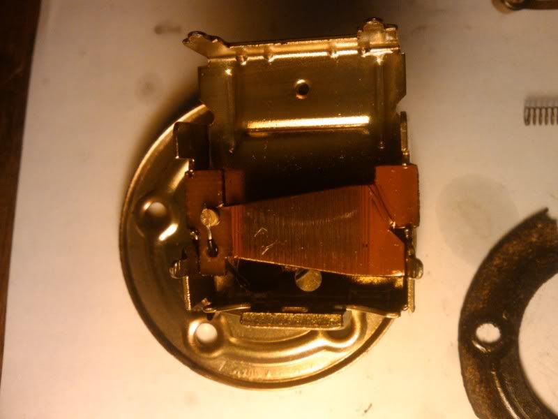

Before you go forward, check to see if the coil copper wires are not broken/severed, if so stop, your OLSU is toast and you need a new one. Skip to Install. If good, proceed to next step. ( I guess in a pinch, your could solder it and reposition the limiter )
Inspect the path of the contact end of the float arm assembly on the coil. You want to see if it glides within the coil cluster not too far or too short. Once open you can better see where it glides.
Mine was not traveling the entire path and one end was going too far off the coil giving me a PEGGED READING. Also the arm was very sloppy due to the arm tension spring being weakened over the years, I could see it literally skip off the coil.
7. Using a needle nose, pry up the 4 small tabs holding the half plate of the OLSU. Make sure you are over a table, there is a Spring surprise waiting for you.

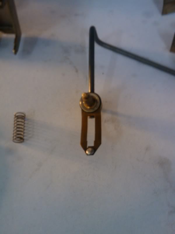

8. Separate the plate and the arm and float assembly will drop out with the tension spring.
Notice old gasket, the reason we need to plug the hole to sump.
9. Place in the bucket, use a brush and cleaner, I opted to use Mineral Oil. Brushed and soaked thoroughly, wiped excess down and let it dry off before adjustments.

10. Copper Arm of Float Arm Assembly, I bent mine about 3/8" to give more tension to the contact on the coils, take care that the bend does not cause the copper arm itself to rub against the coil, you only want the rounded tip to glide on the coil. I also removed any sharp edges from years of grinding against the coils and polished with Dremel. Someone posted a pic of how the OLSU cut thru the coil because of the round edge wearing thru and the stub cut the coil causing a failure.
Copper arm must be parallel to the coil. It is the thin copper thing next to the reddish colored block in pic.
11. Spring, I decided to stretch the spring a bit to give more stability to the pivot point. It did take out some slop but probably due to the bend above.
12. Limit Adjustments, there are two large 45 degree +/- side tabs off of the plate, those are the limiters. Temporarily re-assemble the plates not to forget about the spring and hold by one hand then move the arm to see how much the limiters need to be bent in or out. Take Care to insure the center of the round contact is always in contact with the coil or you will be doing all this for nothing.
Two large tabs at top
13. Once you are satisfied with the limits, test on car, connect the spades then, turn ignition to on position and move the float, your gauge should correspond, max, middle & low. Success !!!
You can see the path, the left shows the drop off and the right shows where it stops short of full path.
With halves held by hand to look at the path limit
and the other extreme
As tested prior to re-install, middle postion

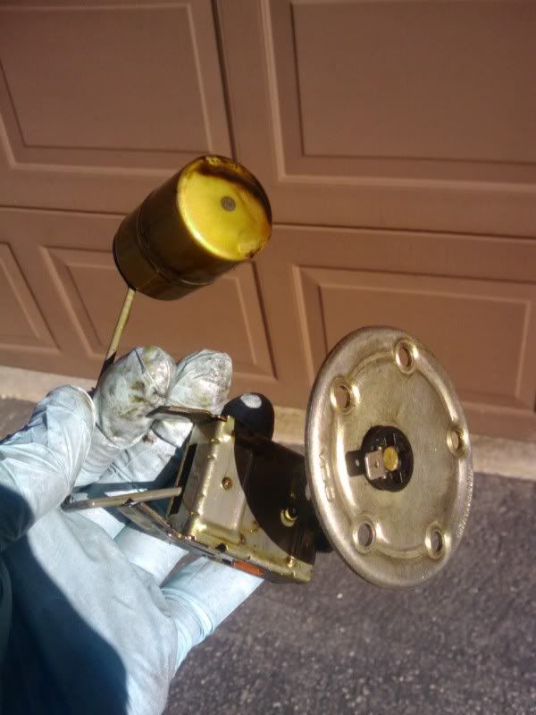

14. Disconnect from wires and bend down the 4 small tabs to secure the OLSU assembly together.
Install:
15. Slip on the New Cork Gasket, find the proper alignment, there is only one way and loosely place a zip tie to set as a reference, others recommended goo to hold in place, I did not want to compromise the gasket.
16. The part number on the OLSU is embossed on the rim, that is the top end orientation.
17. Insert the float, then the arm, dropping it down into the sump, turn OLSU outer plate inwards toward engine then slide main body into hole, flip it back in and place gasket and plate on two bolts loosely, cut off the zip tie and place the washer and bolts. Note the stub closes to you will be the ground attachment for that male spade, put it on first then the washer and nut.

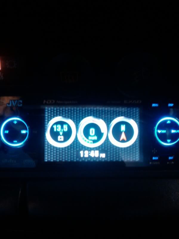

Here are the results:
Gauge Oil Level at 3 o'clock, Oil temp at 190 Degrees ( verified by infrared thermometer )
Dip Stick at middle mark ( fresh oil change, it is the yellowish part to the middle, sorry for bad pic )
No worries JB, here is my Volt Meter , two would have been too much ( inside joke )
OSLU not leaking after an hours drive:

LOL, blind leading the blind.
Use electrical tape in a pinch, the OEM aligator clip ;-), just need contact.
Try to "find the faults first" before spending money, as a Wise Pelican said to me.
I hat efor you to tear into the OLSU only to find a faulty gauge,
