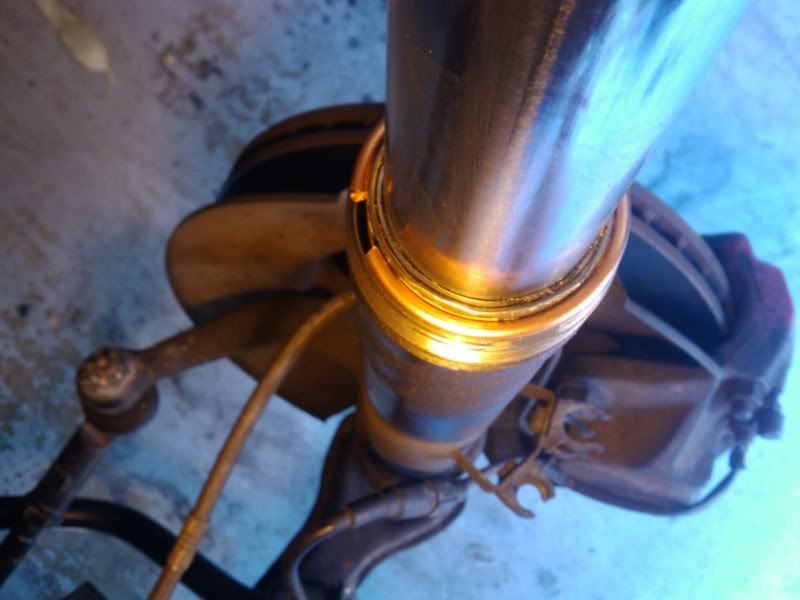

Clunk from the top of my struts
If I push on the top of my wheels I can feel and hear a clunk. I took the wheel off and had my wife shake things until we narrowed it down to the top of the strut/shock. The top mount seems solid and it seems to come from the inner part of the strut top. I was already going to order new Bilstein inserts so is there anything else it could be so I don't get everything torn apart and end up needing something else?

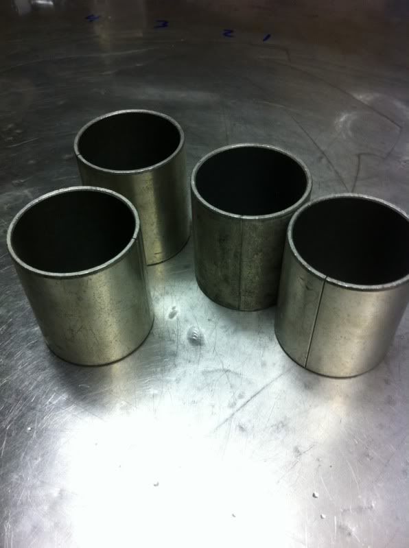

There is an upper and lower bushing in the bilsteins. The upper usually goes bad and has to be replaced, new inserts will not fix it. here are the bushings. common problem!

I had a clunk that AX tech inspectors always freaked out over... Thought it was a very loose wheel bearing... It was the upper bushing in the strut housing.
I replaced the upper and the clunk went away. Also installed new shocks at the time. It is a pain to draw out the old bearing from the housing. I used some threaded rod and a thick washer from a selection of old stuff I have. You will need to have the new bearing pressed in with an appropriate press tool/press. It is too deep and too tight a fit to fudge it in with a hammer and driver.

Here is my Bilstein Insert Fix:
$.89 Fix! If not Loose Bearings, Tie Rods, Bushings, Joints or Strut Housing???
8 Gauge Copper Wire, $0.89:
Acts as a SHIM to remove SLOP:
