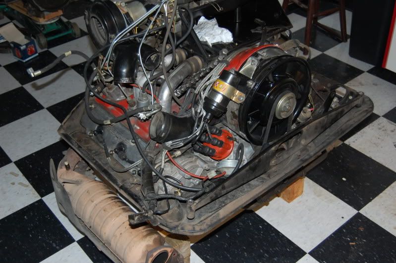

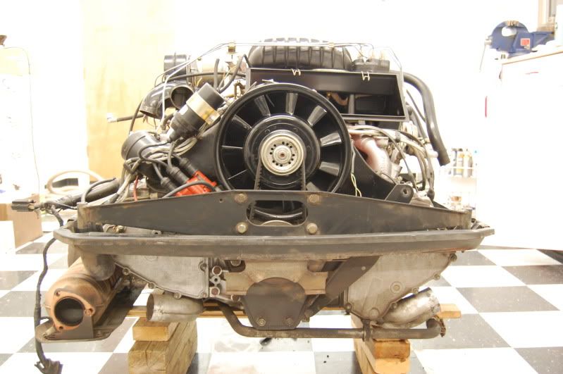

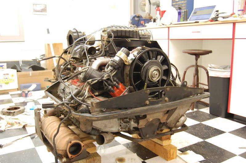

So me and my buddy jim made progress on my 911. He was kind enough to let me use his lift. He's a member on this forum, thought that was extremely nice of him.
Engine is out, transmission is separated, clutch is apart.

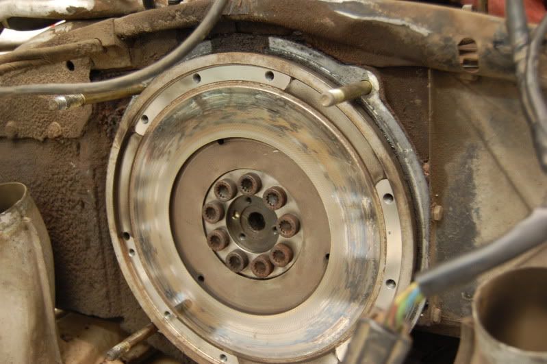

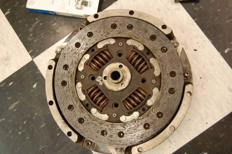

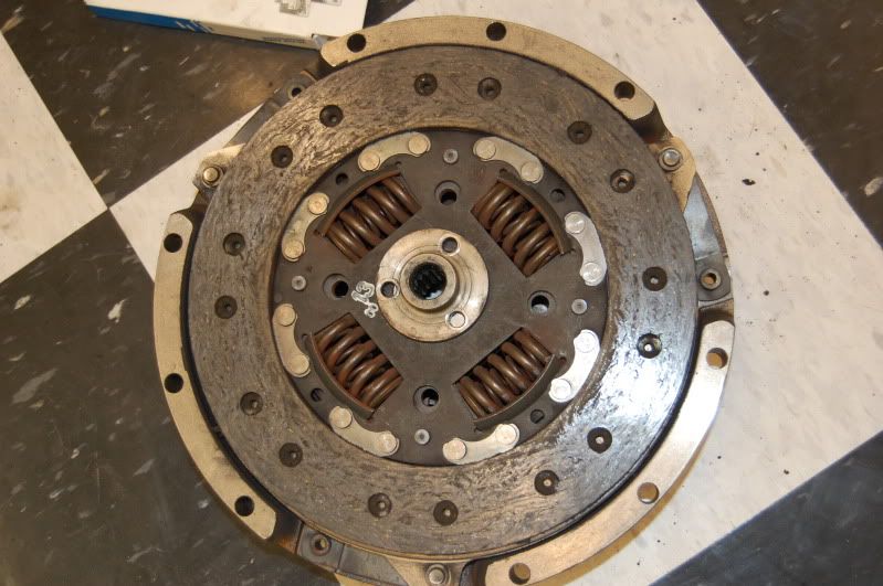

A couple symptoms:
- Power loss
- Horrible gas mileage
- REALLY BAD chatter on the clutch
Now that the clutch is out... a few observations
- Inner ring of clutch is a bright tan color, and same inner ring of flywheel is very discolored.
- Clutch disc material seems to be "okay" - measurement of new vs old clutch disc was about 1/4mm of surface material (not a huge difference).
So... my next question is...
- Is it possible I'm dealing with something else on it? Perhaps the clutch cable? there were times i could get it to engage smoothly but it was RARE.
- Is the inner ring of discoloring bad? The flywheel still has the marks on it where it was turned. You can still literally see where it was turned, and it doesn't look like it was all that long ago... there are a few areas where those spots are no longer present but for the most part, the vast majority looks good.
I was TOLD the disconnected vacuum lines were for the cruise control. Now that the engine is out and i can see the back, it actually appears they were both connected to something it goes to a T and into the throttle body... which is hooked up and going to nothing which is odd. Perhaps they really are for the cruise control and left open from the throttle body?

OK, we are talking about a 1982 911SC.
Is the disc ‘shinny’ polished or oily?
Measuring the thickness of a clutch disc is difficult at best.
You must ‘crush’ the two friction surfaces together.
Two ViceGrips with the pivot-pads work well.
The difficulty is ‘squeezing’ the new and old discs the same pressure to ‘crush’ the spring between.
Most of the time, it is ‘safer’ to simply replace any used disc that is ‘suspect’.
Carefully inspect the pressure plate.
The large finger-spring can be broken from one of the ‘stress-relief circles’ toward the center.
This is sometimes difficult to see.
Another potential problem can be the three flat ‘tension springs’ that transmit the torque from the pressure plate housing to the moving friction part of the pressure plate.
These three ‘leaf-springs’ are designed to operate in tension when the engine is driving the car.
If the car inertia drives the engine excessively, these leaf springs are in compression and can ‘buckle / bend’.
What is the wear on the flywheel?
What is the measurement of the flywheel thickness?
You may want to replace the flywheel and pressure plate with new.
Does the clutch cable Bowden tube have the normal ‘bend’ when installed?
Is the chassis cracked where the Bowden tube seats at the front?
Were the engine and transmission mounts tight?
Was the engine and transmission tightly bolted together?
Does the clutch arm, over-center Omega spring, shaft and fork operate correctly?
Was this properly adjusted?
Is the pilot bearing in the center of the flywheel correct?
Is the clutch release (TO) bearing guide tube tight?
Please post pictures.
I’m not clear about your color and location descriptions.
Is everything as-original with the engine?
Shiny.. yes.. oily no.
w/o flash
I took a pic with the camera without flash and with flash. Here are the results.
w flash
w/o flash
w flash
I compared the old disc to the new disc. Without doing any crushing as you spea of, the difference was about 1/4mm of thickness of friction material.
I already have a new disc, pressure plate, throwout and pilot bearing I plan on installing today.
I didn't check this but this is a very good point, I will inspect the old pressure plate before the new one to see if this is possibly what was causing it.
I am not sure, what is a good way to check the thickness? It's obvious it hasn't worn much, you can still see the machining marks of the last surfacing job which is what surprised me.
I did not order a new flywheel but do have a new PP. Although a new flywheel may not be a bad idea. Although I need to measure thickness first. How would I go about doing this?

New clutch is installed. New seal installed... fixed all the vacuum issues I had. Won't know for sure till we start her up. But am happy with the progress thus far..
Going to mate the tranny back up to it in the morning.
My "this didn't go perfect" so far...
- Broke a pilot bearing bolt off in the crank. Had to extract it. Thought the torque spec was 20ft lbs. Found out it's more like 8-10lbs... from what I'm told.
- Flywheel issue... that was no fun finding out someone borked it, glad I got it fixed.
- Heater box adjustments... those were being a pain. We got those adjusted. HOLY CRAP! I'll have heat!
