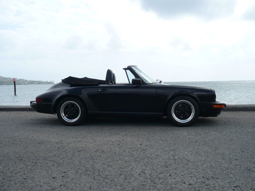

My old cab had the glass below the doorsill.
