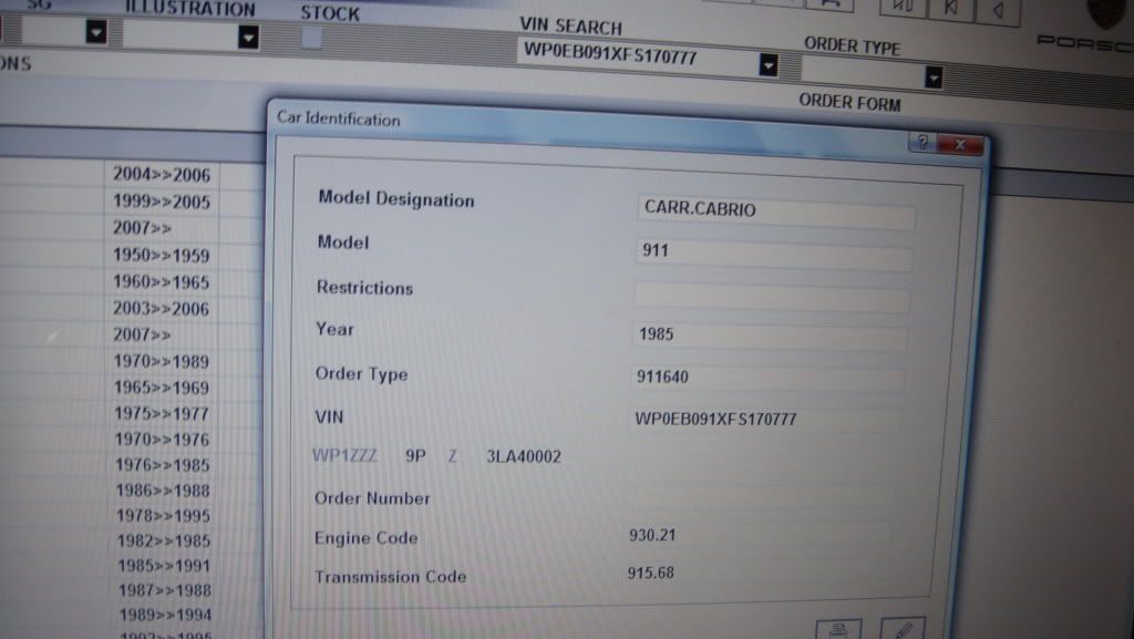

Here is the VIN WP0EB091XFS170777. Im looking at a 1985 Turbo Cabriolet with this vin number. Something wrong? I think that this VIN is just a regular 911. If I remember correctly there were no US model Turbos in 1985 not 1985 Turbo Cabriolets. Am i correct? Any advice is helpful! Thanks!

i ran the VIN thru PET 7 (contains interactive specific vin searches for all yrs both euro & n.amer.)....& here's what it came up with - if you want PET 7 download i may still have the link....send me a pm

WOW! Thanks! Is it possible its a M491 turbo look?

Philip - Are you sure it is ...91XFS...? All I see are ...91CFS... WPOEBO91CFS170000 starts off the US Carrera Cab VIN.
Thats the prob im having. This Porsche has all the right stuff to appear as a turbo including the suspension etc. WP0EB091XFS170777. Possible an M491?

Engine code shows 930, so I assume that the Porsche is an M491 turbo look. ?

No, "Engine code 930.21" is the engine type 930/21 normal 3.2l, 150kW, 911 Carrera USA/Japan/FRG-M298.
M491 is a chassis uprate that is the entire Turbo chassis with re-positioned suspension mounts, turbo trailing arms, axles, brakes, fenders, wheels and more.

According to the Turbo Look (TL) registry.....there supposedly were only 5 Turbo-Look cabs made for USA in 1985.
OK on having Turbo brakes, as the TL cars should have these and would take us closer to finding a factory build..... but I don't understand *at all* the reference to Turbo gauges.
As Grady points out, the 930/21 is the regular 3.2 L normally aspirated engine......and the 915 reference to the gearbox also indicates a "non-turbo" ( motor).

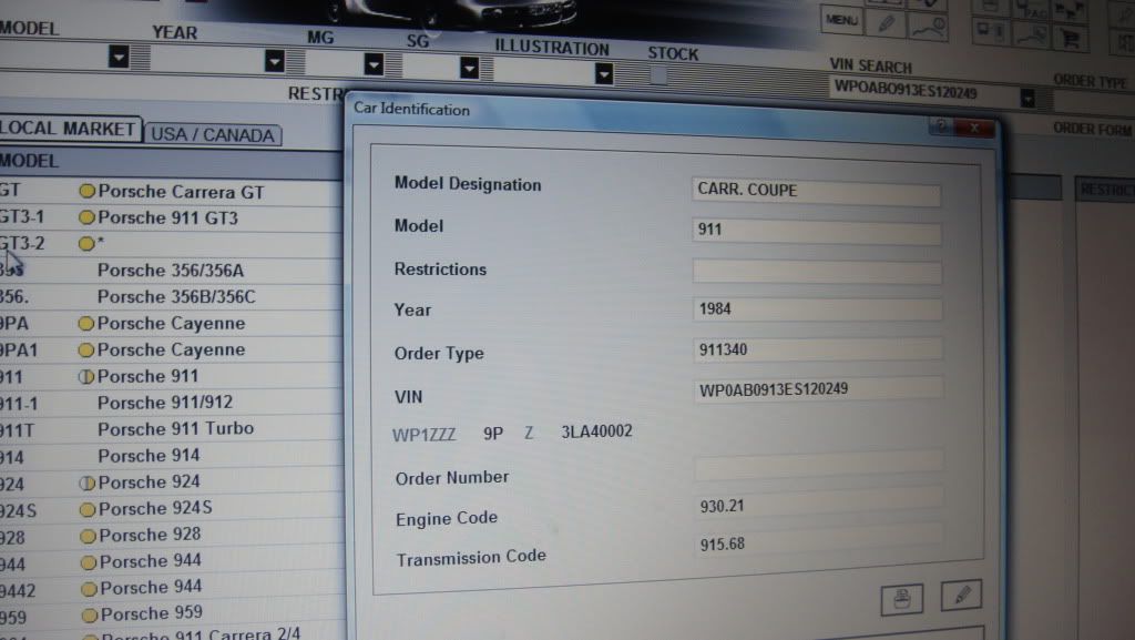

I am looking at an 84 M491 option 911. The chassis number is WPOABO913ES120249. It comes up invalid for Car Fax. All other chassis numbers for US CES, no #3, or ZES for other countries. Any help out there?

carfax is less than dependable for older years. PET 7 delivered this in response to VIN search (sorry cannot download page its a photo....but i've tried to include my VIN input for you to confirm)
I checked the M491 / M470 data base VIN lists.
There were 113 M491 Cabs produced for North America in 1985, but WP0EB091XFS170777 was not a M491 optioned car.
WPOABO913ES120249 is a valid M491 optioned car. #9 of 354 Coupes produced for North America in 1984.
For some reason, the PET data base lists some options with an I instead of a M. So I491 is the same as M491 on the options listed.
PET also only includes descriptions for the M options, so you have to look up the I option codes separately.
