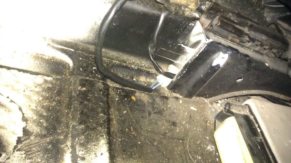

Hi Everyone,
I was cleaning the carpet, when I found a plug underneath the drivers seat that was not plugged into anything. Anyone know where it goes? From a 86.
Thanks

What are the colors of the wires going to the connector?
Being under the drivers seat could be something to do with the DME. Altitude correction unit?

Well I looked around again and found the other plug that goes into this. I plugged mine together but don't notice anything.
I bet it has something to do with the seat belts...

do you happen to know where the other end of the plug was?

It was near the seat...both plug ends were under the carpet.

seat belt indicator plug - other end plugs into seat belt harness - my guess

That's the connector for the inside temperature sensor mounted on the dash, just to the left of the climate controls. It plugs into the heater control box between the seats. You can see it here clearly in the picture:

Porschenut,
Thanks so much! Exactly what I was looking for.

Not on my car...I don't have the temp sensor as I have the manual heat system. Perhaps on my car it does have something to do with the seat belt indicator.
Since my dash lamp cluster is not working I can't see if it is the seat belt warning.

I believe Porsche might have run the wires wether required or not for the sake of efficiency at the factory. Those cars which required it got it plugged into the circuit board, those that didn't, well, didn't. I have the plug, but like many others, it's not plugged into anything. Keep in mind, in the days of the Carrera (mid-late 80's ) Porsche was pumping out a lot of cars, relatively speaking, to the yuppies. Porsche probably (conjecture) tried to streamline production by wiring all the cars the same and then just plugging in the options that were ordered.
I don't have climate control, therefore the cirlced portion on the dash is not populated with the sensor. Also note my control between the seats only goes up to 3. I believe the climate controlled cars have detents up to 10 (I may be wrong on this).
