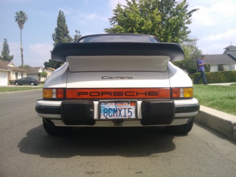

need some input from you guys that have carreras with tails. im installing a tail onto a friends 87 targa and need to know where the script lives. It now lives in the factory tail-less location. any pics or measurements will help. TIA

the center "rr" of the script is 11 3/4" from the bottom lip of the engine bonnet. The "C" dips a bit below the rest of the script, and is located 11 1/2" from the bottom lip.
If you have a tail, your measurements may be considerably different.

This thread should answer your questions
1987 carrera emblem location
