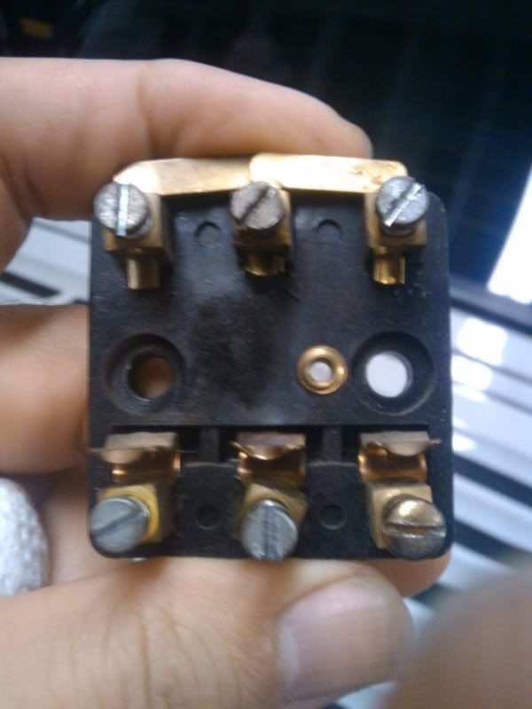

Lightbulb Fix: 3.2 A/C #2 fuse FINALLY!!!!
Hey Fellas!
Here is another fix but credit goes to WWEST, he directed me to swap the #1 Fuse Block. DONE, SHE IS FINALLY FIXED!!! She does not blow the fuse or shrink the fuse from extreme heat causing a short in the A/C System. In fact, I measured the temps on the #2 Fuse and the Wire.
My findings showed 75 degrees, on Fuse holder bottom post and all components stayed at ambient temps.
Issue: For years since I owned her, during the summer on "Hi" she would work for awhile then I would smell something burning or a loud pop from my trunk area then my A/C would die. I went through maybe 6+ fuses one summer The weirdest thing is that when I smelled the burning plastic, the fuse was in place but it SHRANK, WTF
Then last year I had enough and tried to correct the issue, cleaning, polishing the fuse holders, EVEN BENDING THE HOLDER TO INSURE THE FUSE WILL STAY EVEN IF IT MELTED (WRONG) cleaned and lubed Front Condenser Motor also the Evaporator Motor in the Smugglers box, changed Smuggler's Box Relay. Verified Proper Refrigerant Levels. I use ES12a so it is less of a load on the Compressor to boot.
Note: it would never have issues on low or medium fan but after all the above, on high the fuse would melt.
At HIGH position, I measured the temperature on the fuse holder at the bottom contact it reached a high level of 120-140 degrees, OMG! Something is DEFINITELY WRONG HERE!
I took Gerry's aka 86 911 Targa advise before swapping parts and measured DVM readings, The Evaporator Motor had only 10.33 volts on High and 1.7 Ohms when off. Low was 3.5 Medium was 5.6. Front Condenser on HIGH was 12.53 I really did not want to replace the Evap Motor
Well I already ordered the new FUSE BLOCK & Two Rails so I figured it it isn't the block, she will get a re-fresh. I did notice the 8 Gauge HOT RED LEAD going into #1 of FUSE BLOCK 2 had a bit of corrosion, I promptly cleaned it. I would have missed this if I did not replace the rails.
SURPRISE! It fixed it!

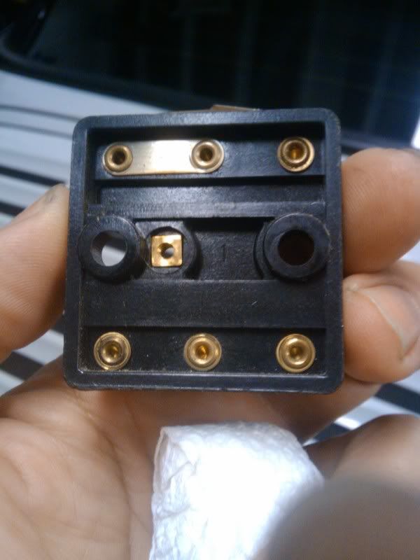

WARNING! The new fuse block is not the same in the back as the OEM when she was put together at the factory.
Front: SAME, (the rails do not go that way, just placed it there so they will not get lost) found bottom post rivet on #2 was loose. but still made the necessary contact.
See the black discoloration #2, that's from all the blown fuses.
Back: The upper brass strip goes to all three posts. I did not want to chance it so I severed the strip in between #1 & #2 Fuse Holder Post. OEM strip on does connect to post #2 & #3. I wonder why PAG installed the rail, in-security???
New Block came with two 25 amp fuses and one 8 amp, maybe they sent me the engine bay block???
Going to the desert tomorrow, will update to see if it truly fixed it or not. Test show good but will try it in the field.

Well, as you can see there was no corrosion in the back but it would not hurt I guess?
My issue was the excessive heat from Fuse Holder #2 made the springiness holder lose it's tension. Sorry I don't know how to better explain it, this is what WWest suggested.
The bonus was it did fix the over heating.
UPDATE: I just returned from being out in the desert at high ambient temps 95-100 degrees and left my A/C on for couple hours on HIGH. She did not pop or melt the#2 FUSE

Fuse Block, apparently the years of use and recent (couple of years to be more exact) extreme heat cycles compromised the holder at #2, losing it's tension quality and also caused too much resistance not allowing full 12volts to reach the blower motors which is the real problem.
The 8 gauge wire on #1 of Fuse Block #2 was a coincidence but I felt it better to clean it anyways.
Why not just try cleaning that first before ordering the part from the dealer at $21.00 and two rails. I would take a reading at the connectors of both blower motors at all level and after cleaning, if no change then the FUSE BLOCK needs to be changed.

If you do end up getting the Fuse Block, make sure you check the back strip, I had to cut it to match the OEM. Also get two new rails.
