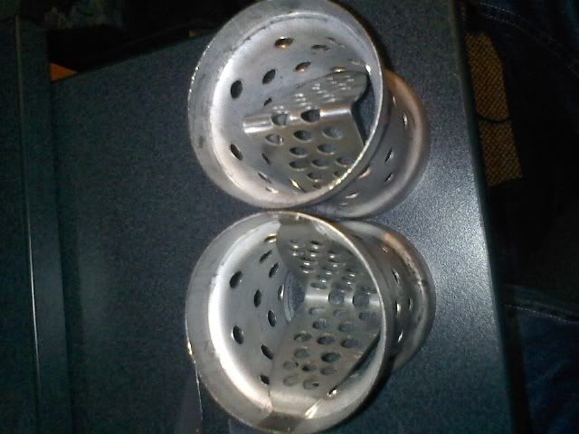

also - just got baffles(from ben) for Ben's GT3 style muffler - since it was droning pretty bad. my only question is how far in do i put them and which end goes in first? should the pointed center be facing out the exhaust (top) or into the ehaust (bottom)?
http://i646.photobucket.com/albums/u...he/baffles.jpg
