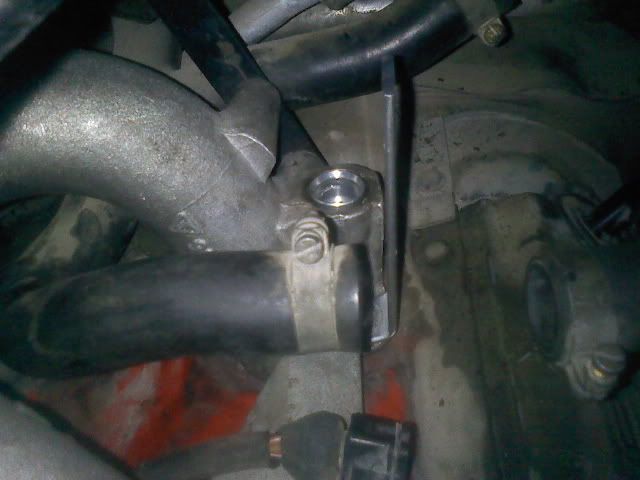

just ran into my first real problem. getting ready to put it back together - while putting on the right fuel rail, i noticed the Decel valve(im pretty sure thats what it is judging by my diagram) is in the way! do i need to keep this at all? i know i need to keep the aux. air regulator, and im 99% certain a fat hose comes from the decel valve to the AAR. if i get rid of this, what do i put in place of it??

The only CIS part you need to keep is the AAR not the round one the long squareish one I think even the accumulator is no longer needed so get rid of all that crap and gobbledegoop in there

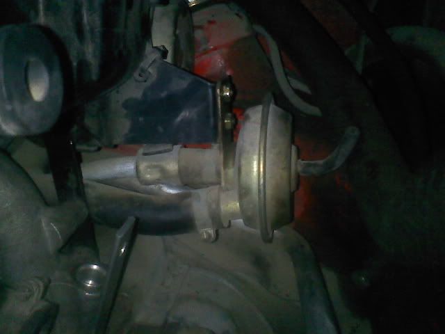

yeah. but right behind it - gonna post a pic of it quick, the bottom hose on the Decel valve connects into the left side of the AAR! where would i plumb a new hose to to complete whatever circuit of air the AAR runs on? this is not described at all in Tbitz manual.
Decel valve - the bottom hoes goes to where the AAR(left side of it) is. - - also the fuel rail fitting on the side facing the front of the car hits the black mount the Decel valve is connected to. NO idea how to remove it...
Left rubber hose = hose coming from the Decel valve that goes into the left side of the AAR.

Your pics didn't load but in Tony's instructions it shows you how to modify the AAR to clear the rail and I would remove all the hoses and extraneous stuff and put an air filter on the AAR inlet and run a single hose to the airbox. Have you been to the bitzracing yahoo group yet? It has a wealth of info and pics.

re linked the pics - should show up now. but that is exactly what i was wondering about. thanks for the prompt reply!
now, is there any way to get the junk off the back of the airbox without pulling the whole thing out? - I literally just put it all back in... i didn't pull that junk off cause the instructions didn't mention them... I think tony will have to change that...

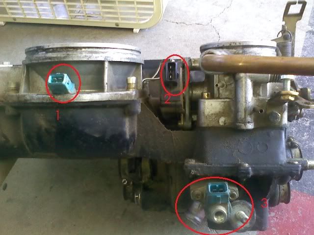

already on the yahoo group - this is so much faster. they dont respond quickly over there... 3 pics coming.
1. airbox drivers side (the side you see faces the front of the car). do i need this copper line? the red circle indicates a splitter that goes to something on the lefthand side of the engine bay.
2. rear of airbox(side that faces front of car). connector 1. is this needed? no clue what it is? same with number 2? number 3 is the cold start valve. instructions said to tape the wire off to prevent shorts - this has been done. now, the outlet of the AAR comes to the small fitting on the lower left side of the cold start valve. do i need to make a new hose and keep that?
3. AAV and DECEL valve. do i need to put an air filter on or can i run a rubber line from the rubber boot to the intlet of the AAR? do i need to make a new "from AAR" hose to the cold start that eliminates the AAV and Decel?

My responses are in red make sure all the unused vacuum ports get plugged that is a common error that results in a bad idle.
Not sure about the copper line I would say no as for the other it goes to the brake booster you need it
You need none of those 1 is the switch that turns on the fuel pump when it detect air flow the pink wire connects to one of these wires to turn off your fuel pump when the car is not running but there is a single plug down by the fuse panel that you can connect the pink wire to 2 is the TPS and is either on or off and of no use to EFI and 3 is the cold start valve and you need to remove and plug the fuel line to this and make sure it doesn't leak vacuum
[IMG]http://i646.photobucket.com/albums/uu183/milo2361/porsche/decelandaav.jpg?t=1312325627
you can run a hose from the boot to the AAR and then from the AAR to below the throttle body right there at the cold start valve and get rid of all that in the pic but if it functions its vauable for those that have not seen the EFI light[/IMG]
