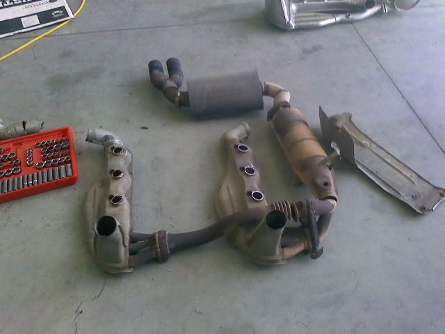

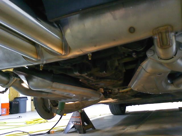

old exhaust off, SSI's and M&K 50% on. just started thismorning. took a sawzall to all the old exhaust to give enough room to get in there - helped a ton. oil lines came off with no issues due to a liberal use of Liquid Wrench, and i had started soaking the exhaust stud nuts the night before with the stuff. sprayin once an hour for about 4 hours yesterday, and then again today when we went to town to get a couple of tools. New oil lines on, Drivers side heat exchanger on, passenger one going on in about 15 min,
All studs stayed usable. i did the liquid wrench soaking, then applied heat w/ a MAPP gas torch (no oxy-acetaline available on a saturday or sunday here) didn't get red hot but did help. a couple of heating/cooling cycles with more Liquid Wrench in between, and application of a constant pressure(No jerking) twisted the nuts clean off, no problems.

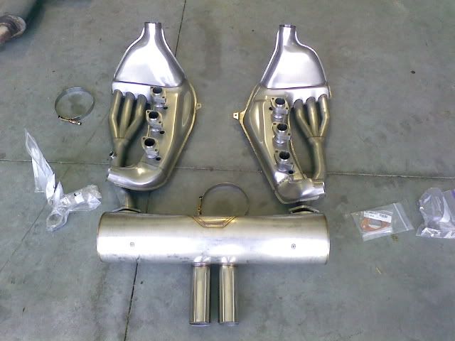

Pics! (only 3, but there's plenty of threads on the subject.)
OLD: basically went to town w/ a sawzall to make it easier to access the nuts.
http://i646.photobucket.com/albums/u...oldexhaust.jpg
New: purdy, aint they?
http://i646.photobucket.com/albums/u...e/headers2.jpg
installed!: oil fill up today, longer O2 sensor wires, then first drive!
http://i646.photobucket.com/albums/u...he/Headers.jpg
