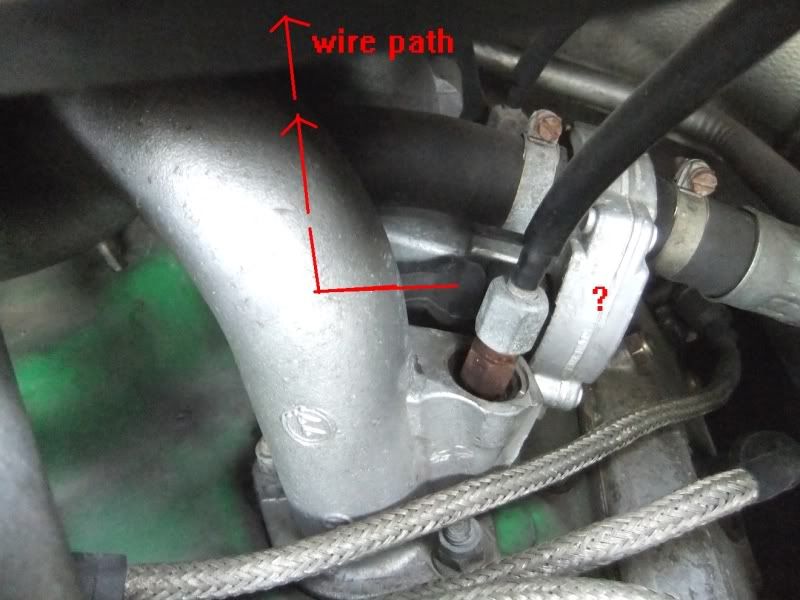

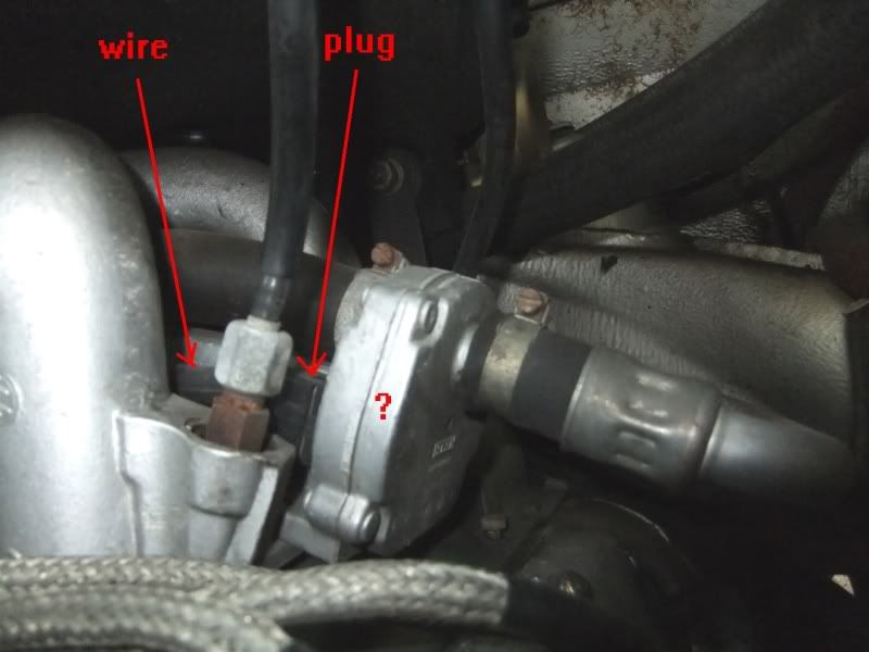

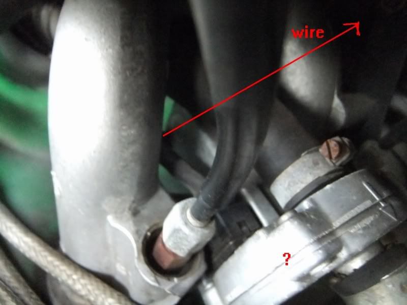

tony, i have two wires both with 2 prong connectors unconnected and 2 ports that fit these connectors on the cis system. i think the two ports on the cis system are on the back of the throttle area

Old 08-22-2011, 06:08 PM
Join Date: Jun 2010
Location: nor cal
Posts: 601
'80 911 sc
'96 Range Rover
Old 08-22-2011, 06:09 PM
Join Date: Jun 2010
Location: nor cal
Posts: 601
those are the last two ports that i was talking about (the last two of my knowledge)
thanks
scott
'80 911 sc
'96 Range Rover

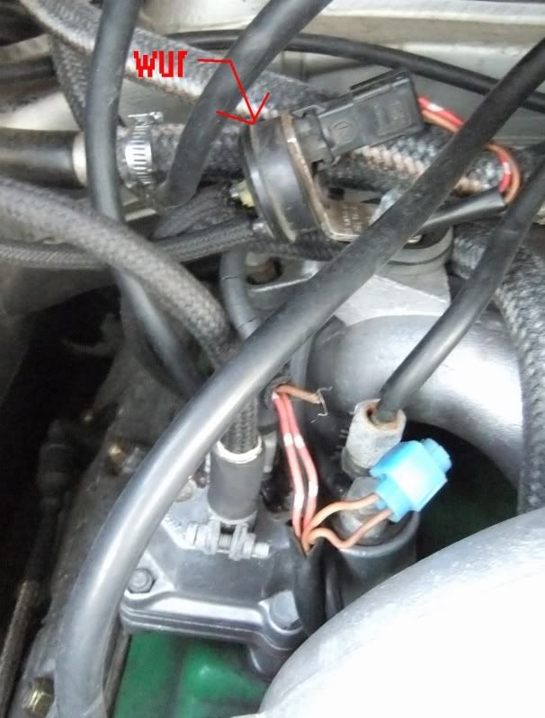

so heres my current situation, there was a wire with a grey 2 prong plug that i plugged into the grey plug on the wamup regulator (im 99% sure about this connection being correct because I remember that same wire having a kink in it before).
I then plugged the only wire with a 3 prong connector (that im aware) into the only thing with a three prong connector that im aware of (which was the back of the throttle area).
I then plugged the black wire with a black 2 prong connector that was on the passenger side of the engine bay into the Aux air regulator (this move was a guess but i just figured it would be color coordinated).
This then leaves me with two wires both with 2 prong connectors and 2 2prong connectors on teh injection system (the ones shown in the pictures above), and these two wires:

tony, i thought there were only 4 two wire plugs but i just found the blue one (the fifth)
i have 3 unattached wires( the blue plug one, the olive colored one, and a black one on the passenger side)
heres what i have so far
WUR (driver side) - done
AAR (passenger side) - done
CSV (engine rear side) - not hooked up
AFS (engine rear side) - not hooked up
FV (engine rear side).......for '80-83 SC only. - not hooked up
if you happen to know which color wire goes with which component that would be a great help

heres my guess for the remaining three (though i know better then to hook up based on guesses). I would say:
the wire with the blue connector goes to the cold start valve
the wire with the black connector goes to the frequency valve
the wire with the green connector goes to the air flow sensor
as a result of there being two different black 2 wire plugs in the cis wiring, i feel the need to differentiate between the two by saying that the one i am talking about that i think goes to the frequency valve comes from this 6 pin connector by the rear driver's side shock tower

blue to cold start valve, green to sensor plate switch, black to frequency valve, another black to aux air regulator, gray to warmup reg.

The black to the FV, needs to be the one coming from the O2/throttle switch harness. If you plug in a" black" plug to it, and it gets +12v, a hole burns in FV near the plug after a few miles and it sprays a lot of fuel out.

The two (2) plugs that commonly get interchanged are the CSV and AFS plugs. A quick way to identify or test these plugs is by inspecting the wire colors. The AFS (air flow switch) has 2 brown wires. This is the only plug in your CIS engine harness that has all brown colored wires.
