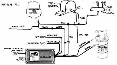

Is my new MSD bad? No spark at coils.
I just finished installing my MSD with Pertronix and dual MSD High shock Coils as it's now twin plug and I'm getting no spark. All wires are correct and I have verified power to the unit and have a sold ground.
I have tried to spark the coils but get NOTHING. Am I missing something or is my unit bad? I have a spare but wonder if I should try something else 1st...
Any help is appreciated.

Can you post a wiring diagram of exactly what you have installed?

This is it.

You might trying to simply the wiring first...leave the adapter and one set of boxes out. You say you have twin coils and plugs but the diagram above only shows one set.
I have twin-plugged with MSD and didnt need the adapter or the pertronix so I cant help with those.

@ JohnJL yes I'm running the coils in parallel as recommended by MSD. I am able to get spark at the coil by disconnecting the white wire and grounding it. Still no spark at the plugs however.
Could the problem be with the Pertronix
